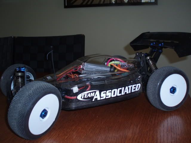

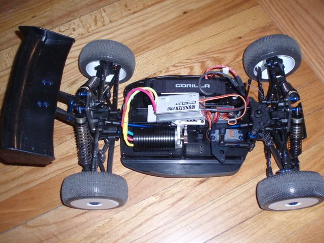

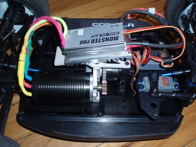

I just wanted to share a few pics of the RC8. 15151y, Quark 125b, and misc parts rc-monster (servo holder & pinions) and rcproductdesigns (mount & integrated battery box/mud guard).
She seems to run great. The quark is really smooth, absolutely no cogging whatsoever. The brakes seem a little harsh though. I did a few runs up and down the street on 3s while I wait on my new 4s flightpower & new energy packs to get here. I bought two TrueRC packs but sent them back as they are too wide for the battery box by 2mm. The 3s 8000 probably had her doing about 30 mph.
I can't wait to try her out on the track next week which is what I built it for.

Great conversion!! That motor must be quite the challenge to control in a 1/8 buggy. Must have torque like nothing else...
