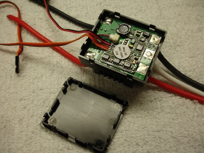

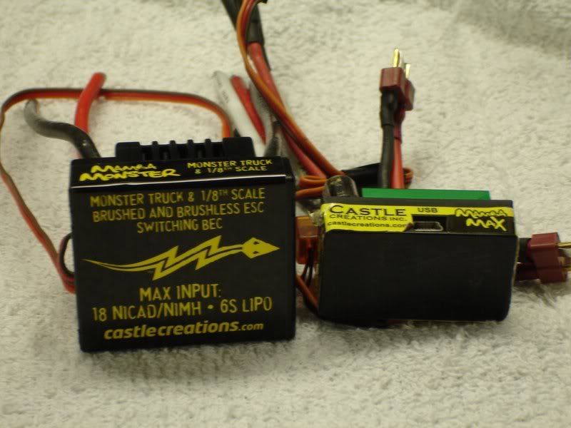

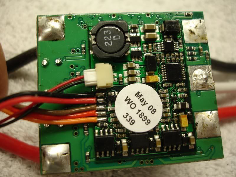

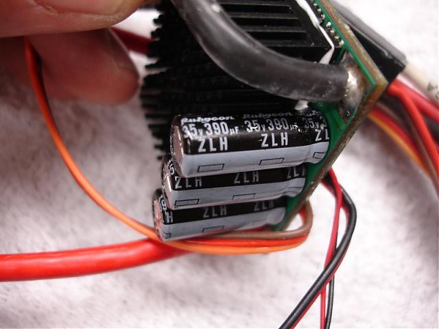

here's some pics I took for those curious what's inside, etc

How easily did the case come apart? The reason I ask is my Sidewinder case came apart a couple times at the track, the cases are identical in the way the two pieces come together.
glassdoctor
TEAM FUSION
glassdoctor's Avatar
Posts: 2,041
Join Date: Jul 2006
05.10.2008, 02:28 AM
Seems to be a solid case design... there are lock tabs on all four sides. It's easy to take apart but with 8 tabs I think it should hold together very well.

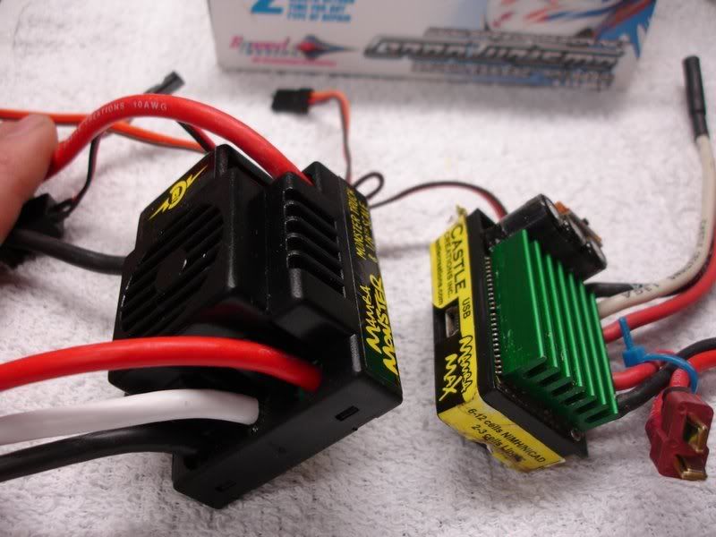

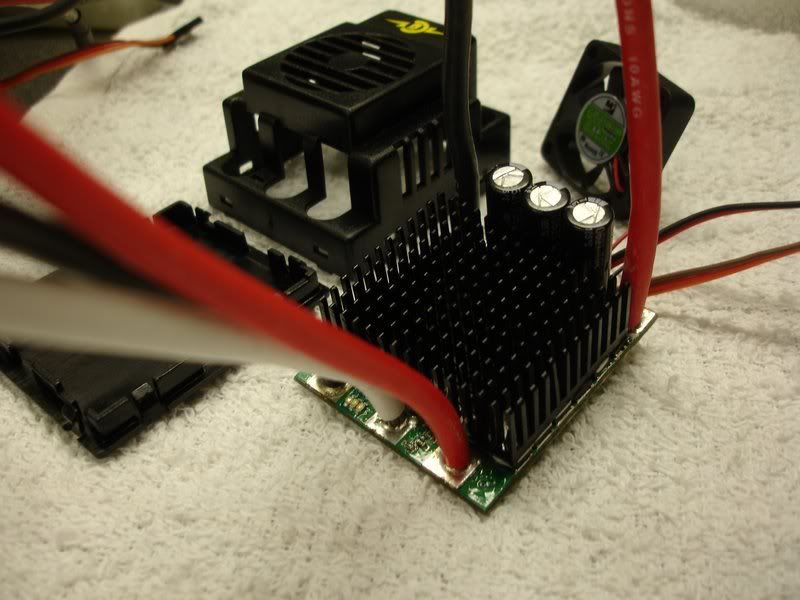

It's HUGE compared to the MM... especially with the case!!
But the total of the guts isn't much more, if it was configured in a double deck, narrow design like the MM. The fat wires add a lot of weight in comparison also.
I have it ready to run now but it's late and I'm not feeling too great.... so maybe tomorrow I can get some runtime and hopefully a little video too?

To compare, I weighed a Mamba Max with 30mm fan and UBEC, all wires etc and it was about 3.9oz.
If I used 12ga wire on the Monster, it might drop it to about the same?
Future production runs of the Monster will have the bullets, so that would be an option.
I don't really see the need for more than 12ga wire unless a setup is pulling a constant 100+ amps... which is very rare. But, Castle thinks the 10ga is a good thing. :)

im liking that fan replacement all the more now... with a convienient clip too!!

Yep, and the fan just slips into the top of the case, anchored on little posts. It's 5v btw...

awesome... how fast does it spin... i got one noisy ass fan which creates more airflow than my 80mm fans...on 5v... and im not joking!! also i can get them for $5... hehe

I can't understand why this MMM have only one layer of printed circuit, and the MGM controller have 3 layer of printed circuit, and it's rate for about the same
Pdelcast
Pdelcast's Avatar
Posts: 1,697
Join Date: Mar 2008
05.10.2008, 11:49 AM
It's two circuit boards on the MMM - One six layer ultra heavy copper power board, and a four layer, high density control ("brain") board.

Castle uses more powerful FETs, apparently.
