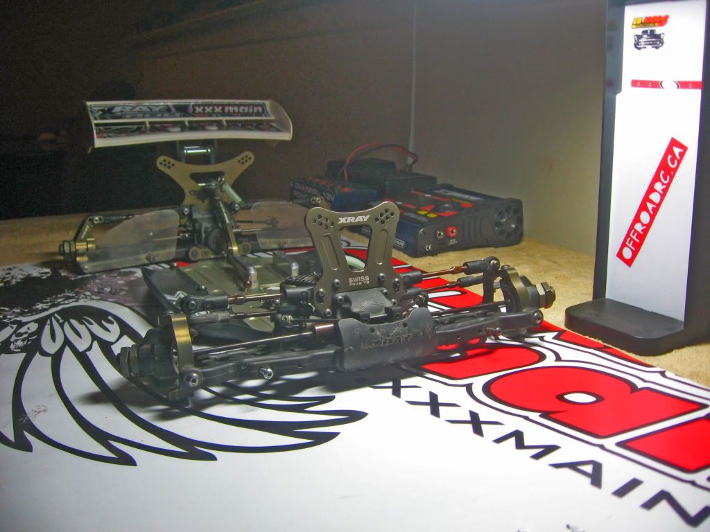

FYI, this is the winter project!! E-XB808
