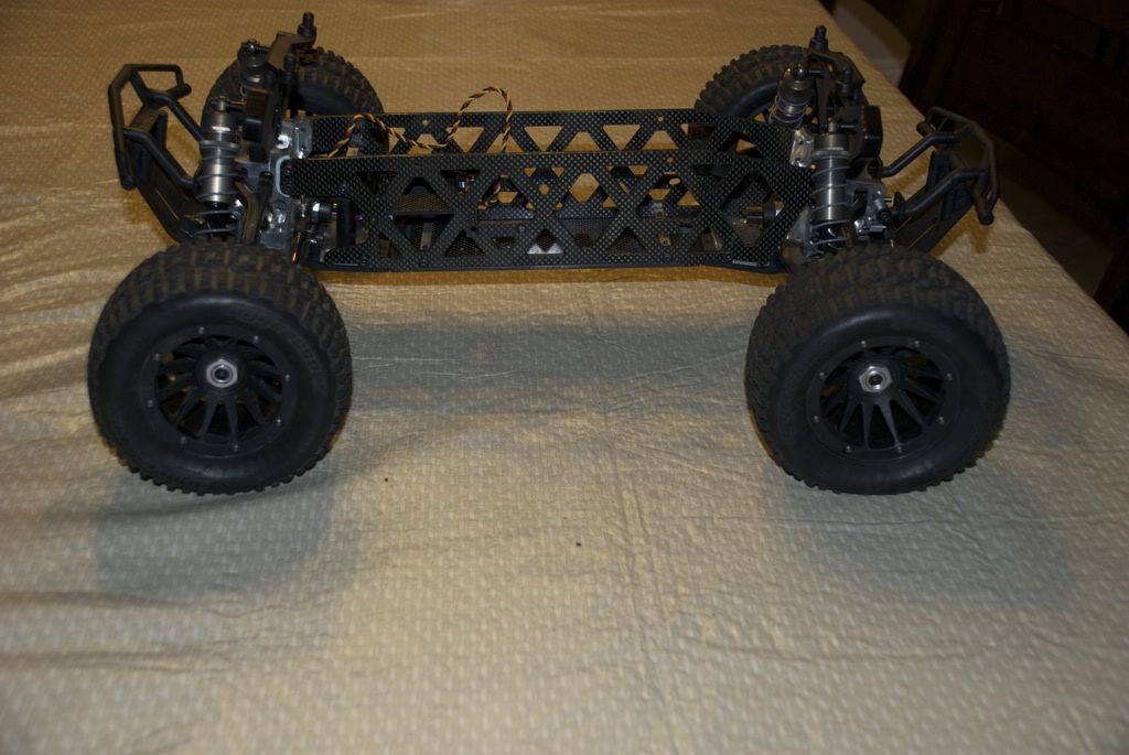

An overall shot of how it will look:

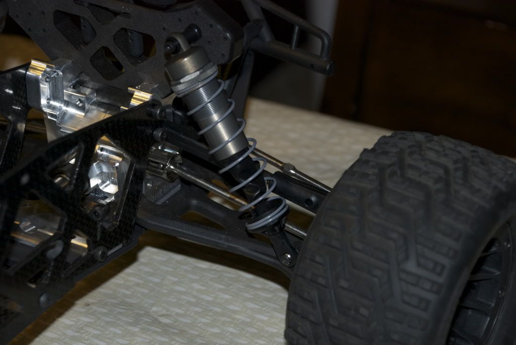

Side view of the TVPs:
The center trans here will be running a Revo slipper driving a standard 1/8th center diff. It also serves as the front support for the motor plate so it can be adjusted from bird's eye view:

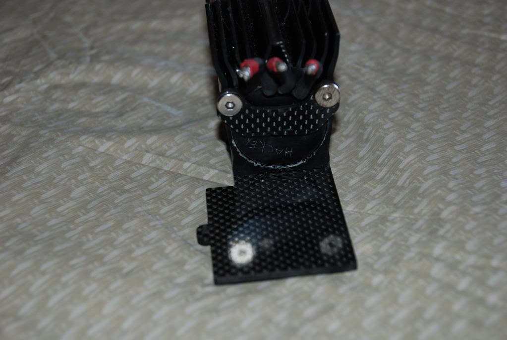

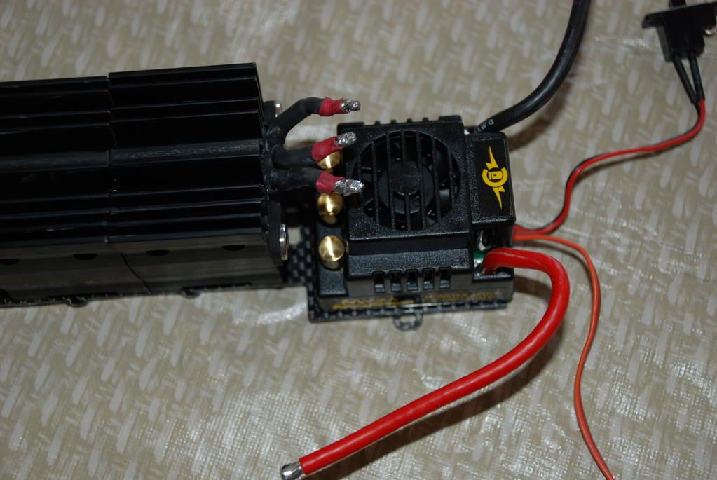

Motor is a Hacker inside Novak heatsinks for their conversion kits. MMM moves with the motor on its plate:
Both front and back of the motor are clamped in place:

looking good!!, what model of hacker is it and what voltage are you planning on running??

It's a B50 8XL (2000kv) and I'm running 5s 2p 5300 Elite packs. Aiming for the longest bashing time possible!

any idea how much its going to weigh, wonder if you dropped much going to the carbon fiber

Don't know on the final weight yet. The batteries are quite heavy, so it will probably be close to a stock nitro version. The CF is really just for show on this one. The weight difference won't be worth a damn. I'm going to get a pair cut out of aluminum also.

I like the MMM and motor in one unit like that. Will the battery trays be adjustable front to back to adjust weight distribution?

The battery trays are fixed in the center of the truck. They are sized for big packs (190mm long), so a standard sized pack could be shifted fore and aft.

Got a couple things on it today. Jammin SBB shocks, and the wheels. Machinist said he'd be done counterboring the bearing holes and tapping mounting holes in the parts by the end of this week, so I may even be able to drive it by this weekend!

How much are those chassis plates stretched?? Look great!

They are stretched 1.5" over stock .25/x plates.

...that looks great!! Have to agree with the flat tvp's...nice job...inside servo too...nice job...we are almost brothers :D
