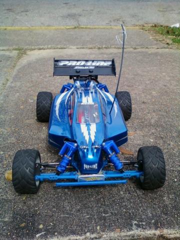

This is my slash I built from a rustler vxl. It has a Mamba Monster 2200kv system and mod1 gears with a Futaba 2.4ghz controller.

03.08.2009, 04:15 PM
very nice! How many cells are you running?

03.08.2009, 04:25 PM
I can only run 4s for now because that is all I have but I plan on running 6s in the near future.

03.08.2009, 04:21 PM
thing looks very good.

03.08.2009, 04:47 PM
lol why? that thing has to be insanly overpowered

03.08.2009, 05:01 PM
is that the stock trans case or a FastLane?

03.08.2009, 05:36 PM
The transmission is stock vxl and I had to mod it so the motor would fit. I have thought about upgrading to the FLM transmission but I dont want to make the rear end any heavier since the motor is already pretty heavy.

03.08.2009, 05:40 PM
your gonna go through axles and output yokes like crazy unless you get a nice set of cvd's

03.08.2009, 08:32 PM
I do have a set of cvd's that I run with my anacondas but I can't run them when I am running my 17mm buggy tires. My cvd's threads are a tad bit thicker than stock threads are and won't fit the 17mm hex adapters.I use Jato shafts when running buggy tires. so far no problems.

03.08.2009, 09:32 PM
Nice. I had my Neu 1515 in my Rustler for a little bit but it was way too heavy and more power than I could possibly use. The Jato shafts and steel outputs held up fine, but I tore up stub axles like mad.
