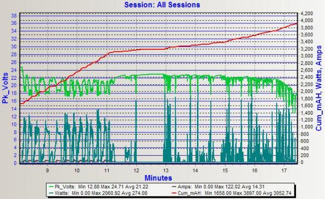

Okay, okay, before we go any further, I'd just like to say there is actually not much difference. I don't know why my older eagletree data is so much different, I guess the grass MUST have been that much shorter...
First one is a year ago on 7s2p pack, geared for 45mph, the second is bow ties on 7s1p(geared for 45mph), third is same but with badlands.
The first one is pulling only 300 watts WOT, the grass must have been shorter, but it's also faster because the voltage drop on the 7s2p is not near as bad on the 7s1p pack.
The second on bowties is pulling average of 900watts I looks like on closer inspection.
The third on badlands is pulling 800watts on average and is definitely a few mph faster.
But I am not sure that my eagletree is working right anymore... lol I'm seeing things here and there that are just to off to be right.
