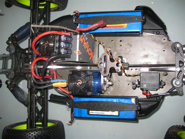

Here is my first BL conversion.
A GS XUT pro truggy,first XUT I have seen BL converted.
My first attempt was to use Hobby Wing 150a esc and the 2000kv motor with 6s lipo.
The HW ESC lasted 10 min before it blew up, then I bought an Mamba monster ESC ,then the HW motor blew up.So now I use complete Mamba monster combo and it works well.

08.26.2009, 09:42 AM
Hey I am dyeing to know how you did this. Can you explain in detail? I want to convert my XUT to brushless so badly. What would you recommend that wont burn out?
woom1970
woom1970's Avatar
Posts: 5
08.26.2009, 03:31 PM
Sorry for my bad english writing.
My second setup for the XUT, I made a motor post from 4mm alu L-profile,used the orginale engine post holes in the chassis plate.Novak battery trays and Losi 8ight t mudgards .For the ESC I used a 3mm alu plate on the top off the middle diff post almost like RC-monsters post,so the ESC sits behind the diffpost above the driveshaft for the rear diff.I used a Traxxas Slash reciver tray and mounted it on top of the steering servo.
My brushless combo is Mamba monster 2200Kv,2x 4000mah 3s 30c lipo (cheap China battery)
So I can see no problem with 6s lipo on the Mamba monster at all.
MY spur gear is 58t mod1 and the pinion gear is 15t,but I will change to 13t
I run with open diffs to protect the drive train.
My XUT is built for bashing not for the race track.
So good luck with your conversion,keep me updated.
TRX E-Revo BL,TRX Slash BL,Kyosho Lazer ZX-5 BL and GS-Racing XUT(Rue Edition) BL

09.01.2009, 02:59 PM
Can I ask you a question woom? How did you make that electric motor plate? do you still have the plans for it? can you be so kind to send me the blue prints so I can make one myself? I was gonna use a savage tranny to eliminate the roll before it catches gear but I decided I don't really care.
brushlessboy16
brushlessboy16's Avatar
09.01.2009, 03:25 PM
ITs an rc monster motor mount
using a transmission throws all your ratios off.
keep the CD
KISS.
Troopermanaic
Posts: 8
Join Date: Aug 2009
09.01.2009, 03:51 PM
is it this?
http://www.rc-monster.com/proddetail.php?prod=RCMCRT1
brushlessboy16
09.01.2009, 04:16 PM
read it. its for an ofna. this is not.
there is a slight possibility that it fits though
