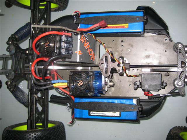

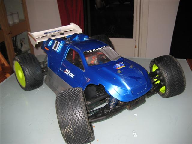

Here is my first BL conversion.
A GS XUT pro truggy,first XUT I have seen BL converted.
My first attempt was to use Hobby Wing 150a esc and the 2000kv motor with 6s lipo.
The HW ESC lasted 10 min before it blew up, then I bought an Mamba monster ESC ,then the HW motor blew up.So now I use complete Mamba monster combo and it works well.

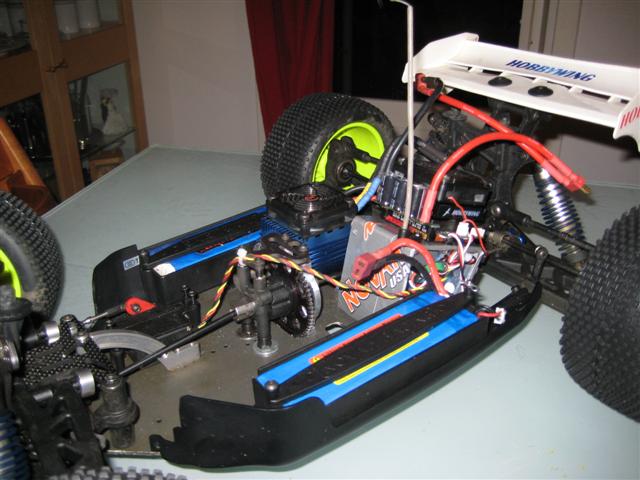

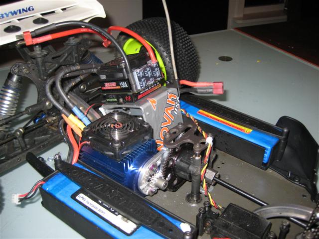

My second setup for the XUT, I made a motor post from 4mm alu L-profile,used the orginale engine post holes in the chassis plate.Novak battery trays and Losi 8ight t mudgards .For the ESC I used a 3mm alu plate on the top off the middle diff post almost like RC-monsters post,so the ESC sits behind the diffpost above the driveshaft for the rear diff.I used a Traxxas Slash reciver tray and mounted it on top of the steering servo.
My brushless combo is Mamba monster 2200Kv,2x 4000mah 3s 30c lipo (cheap China battery)
So I can see no problem with 6s lipo on the Mamba monster at all.
MY spur gear is 58t mod1 and the pinion gear is 15t,but I will change to 13t
I run with open diffs to protect the drive train.
My XUT is built for bashing not for the race track.
So good luck with your conversion,keep me updated.
