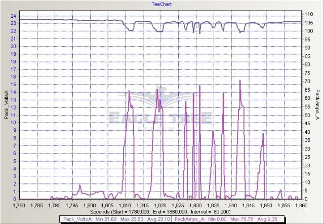

will be updating this thread as i get new data.
first test today.
rEvo conversion, 3905 tranny, geared 17/65, 17mm talons, traxxas stock CD
Turnigy 6s 5000mah 30C pack
put as much power down as i could without wheeling or unloading the front too much.
need to pull more amps to get real data for you guys but this is just an idea of what we are dealing with.
more data when i hot up the setup more, comments and vs against high end packs welcome!!

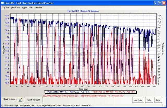

Very Interesting. Thanks for posting that Shaun
Compare the 20C Version of this cell to the 30C version of the same cell.
I believe they are the same!
They BOTH are the same size and weight. The 30C shows a few grams heavier, but those packs come with 8Ga. wires instead of 10Ga. wires.
I've suspected this for awhile now. I have an Eagletree graph of the 20C cells.
Here's how your graph and it lines up:
30C = 3.6 volt per cell average under a 71 amp load
20C = 3.59 volt per cell average under a 113 amp load
The Graph I have is a 3S pack.
Granted there are some difference in the two graphs, but pack temperature/cycle age...etc. will make results vary.
They appear to be the same cell, in size, weight and performance.
Here's the Graph. Check it out and see what you think.

I believe their Current 20C AND 30C packs are the same and are built from the same cells.
I run 4S in my E Revo. I have both 20C and 30C Turnigy Packs and I can't tell ANY difference in the two as far as how they perform.

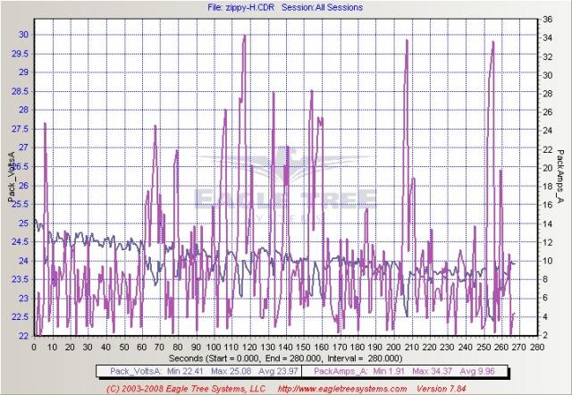

more data from today's race.
marked on the pictures is the battery brand name.
they are:
Turnigy 6S 30C 5000mah
Zippy-H 20-30C 5000mah
both under racing conditions, amazingly we didn't get much more than 45 amps from racing!!
so finding real load to test how well these packs go under heavy load might be harder than it looks!!

10.04.2009, 04:47 AM
The Zippy's seem to perform a very little bit less, but not by that big of a margin (but you probably have run these packs more often then the Turnigy pack). I'm planning on buying myself a 5S in the short term and am kinda playing with the idea to get a 20C pack for my 1515 1y and MMM.
I'm a bit confused I guess. You are running the MMM combo which requires, or at least people / CC / HPI advise, to run with at least 120A continues battery delivery correct? And from racing, where the loads are probably higher than some random bashing, the loads don't even touch 50A, or did you gear it down a lot ?

10.04.2009, 06:05 AM
well the data is generic so it's irrelevant to setup...but ANYWAY.
both are revo's.
turnigy revo (converted 2.5 with CD) is mine, geared for 45mph with a MMM 2200 combo, this was first race on the pack, hasnt even been "broken in" yet
zippy-H revo is a converted platty, MMM + medusa 70mm 2000kv, the pack has about 4-5 hours runtime on it.
geared for 40mph
both have 3905 E-maxx trannies but the 2.5 has a crappy traxxas CD.
i actually cracked the chassis on mine today i did land pretty hard and pulled somer serious G's
