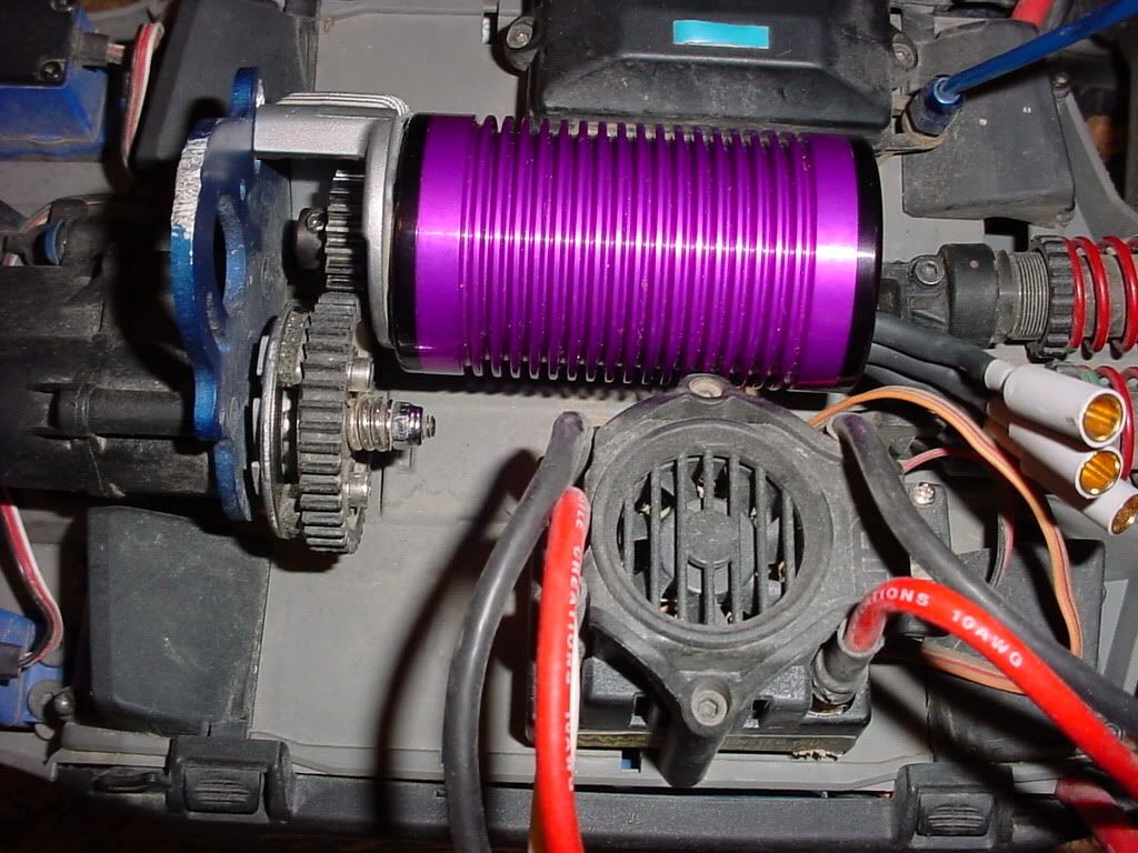

I just finished installing new diffs, center driveshafts, and greasing the boots on the cvd's.
Now it's on to the "fun" part!
I've played around with several Medusa Motors, so now it's time for something bigger and better.
The Mod 1 gears are great in the E Revo, so let's use those. Small on the spur and big on the motor gear. The 11XL is a 1476kv motor, so we're gonna start out by gearing 22/40.
It's pretty neat how this gearing works out.
40 MPH on 4S
50 MPH on 5S
60 MPH on 6S
There's still some work to be done. The ESC connection has to be made to the Motor. Aaaah but soon the runs will come. (Kinda like after you've had too much chili and chocolate chip cookies) LOL

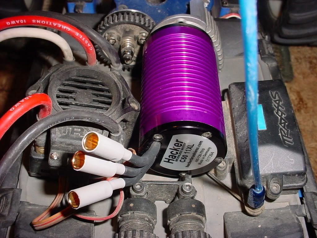

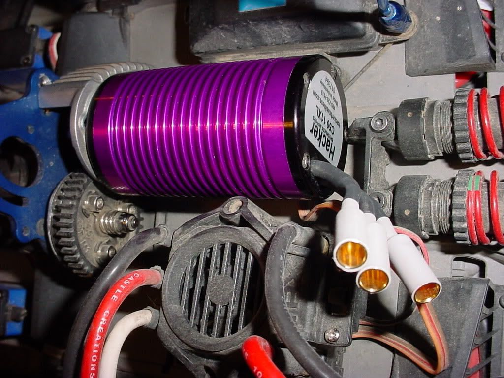

Here's some pics. She's a tight fit, but it does fit perfect.
Any thoughts on how it's going to perform? Temps? Is this gearing good?

Beautiful! That C50 should be PLENTY in the Erevo! Linc compared them to the Neu 1515 line, so they are powerful, quick revving 2 pole motors!
I dont see any problems with gearing, looks ideal to me! What tires are you running?
Solder up some connectors and go make some runs! Its 11pm my time and I just got through running my Emaxx in the yard and the streets. Its quite loud when you flip on the streets and it goes sliding on the lid! O well.
