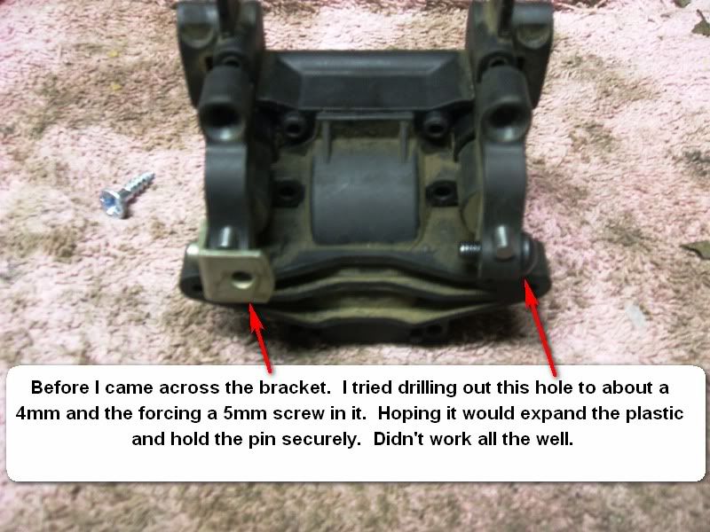

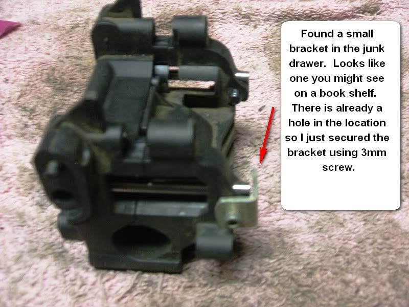

Was hooking up some led lights on the savage and for some reason thought about this thread and got side tracked on the lights. This is what I came up with.

That's basically what I was thinking too.
