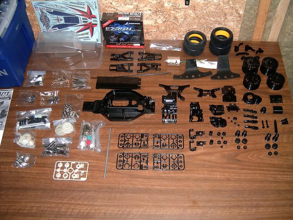

HI!... Anyone here running a Tamiya "DARK IMPACT"?
I just ordered one a few days ago and it should be here in a week or so.
1st off I'll be doing something a bit different with my DF03. I'll be building a custom DF-03 "HORNET". Kinda combining old school with new school. Here's a few pics of what I'll be doing :

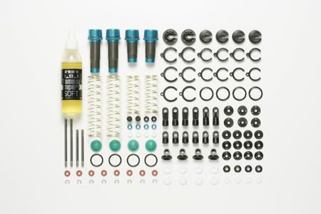

- 3RACING aluminum front/rear shocks :
Or spend the money on the
- TAMIYA oil shocks :
Which shock set-up would be better?

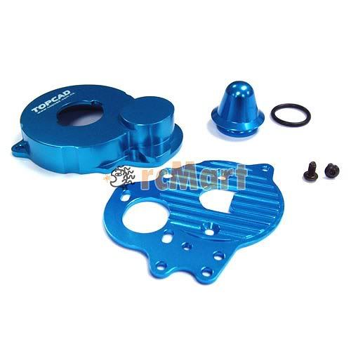

- TOPCAD motor heat sink plate :

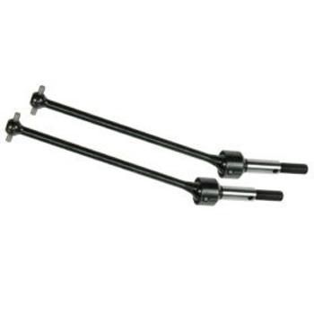

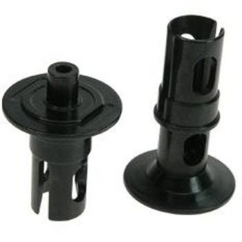

- 3RACING front/rear Diff. Shaft - Heavy Duty Ver. 2 :
Now what would the best CVD be, to buy?

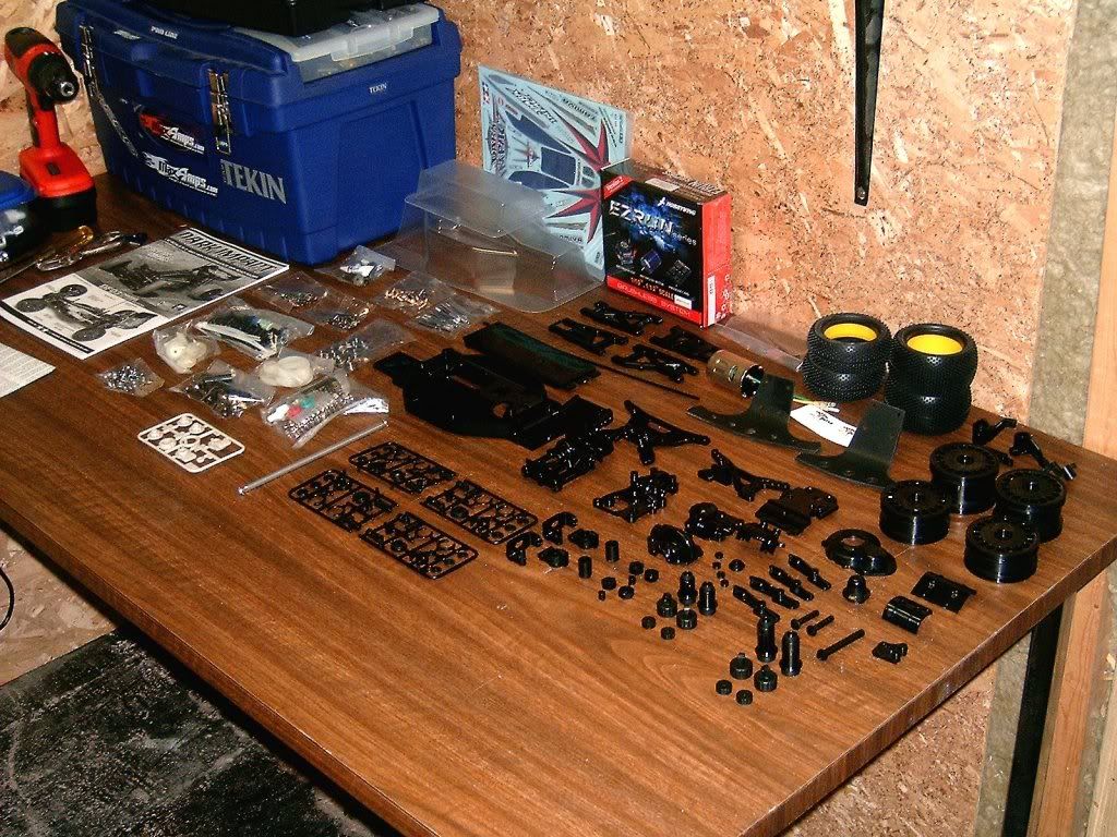

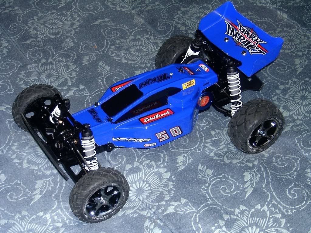

HI!... Well I picked the DARK IMPACT up on Friday and started building it right away.
Well I made a stupid mistake and put all the stickers on and afterwards realized the body had a clear tear off coating on it! LOL! So needless to say they are all scrap now. So after painting the body today I just threw on some stickers I had laying around.

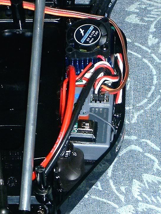

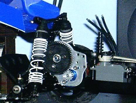

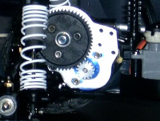

HI!... I didn't car for the spur/pinion gear set-up on this thing. Teeth are way to fine. With me running a brushless 6000KV motor I figured they wouldn't last too long. So I built a conversion kit and converted it to a M-0.8 gear set-up. Currently running a 54spur/15pinion.

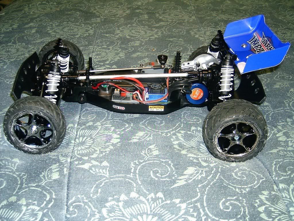

Here's my ESC/RECEIVER set-up :

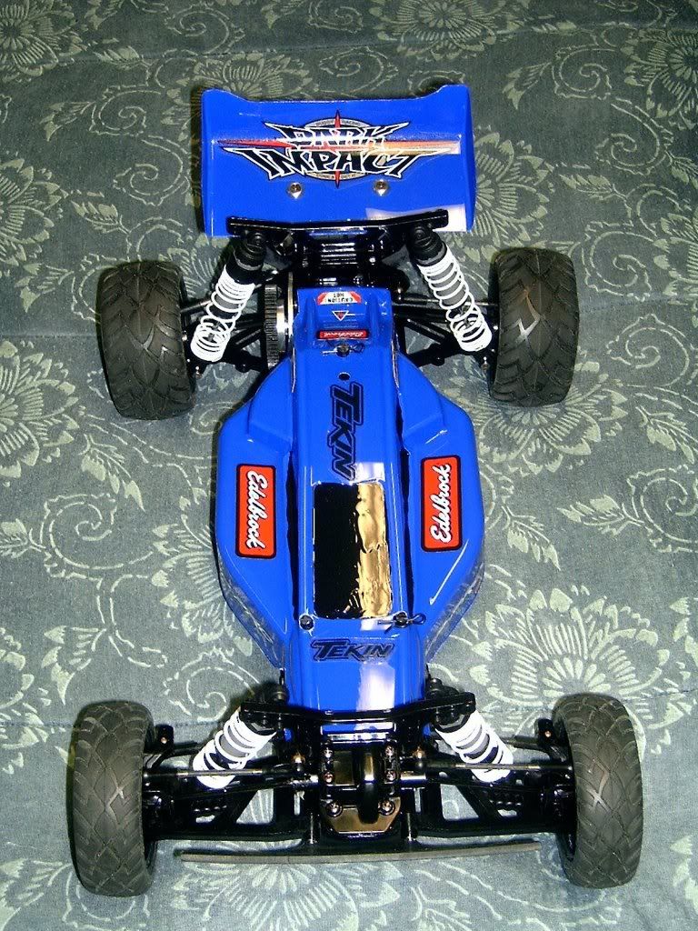

Looks great! You know in the first picture the back tires need switching around to make the tread direction right unless you are doing that on purpose and in the las picture all the tires are on wrong. Regardless of the other pics in which I didn't look at the tires. Nice job otherwise! I was thinking about doing one of these but I didn't know it had a ball diff.

Looks great! You know in the first picture the back tires need switching around to make the tread direction right unless you are doing that on purpose and in the last picture all the tires are on wrong. Regardless of the other pics in which I didn't look at the tires. Nice job otherwise! I was thinking about doing one of these but I didn't know it had a ball diff.
HI!... Ya I just threw the tires on for the pic. Really didn't care which way they were facing at the time. lol!
