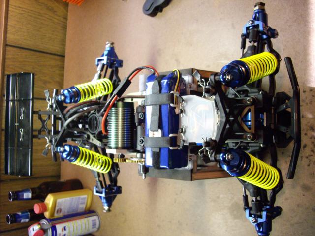

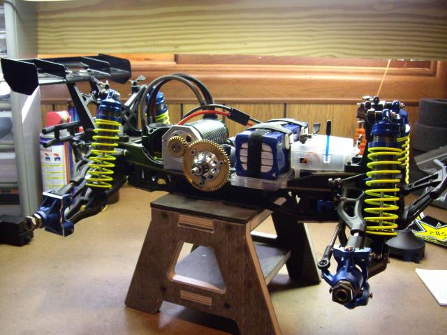

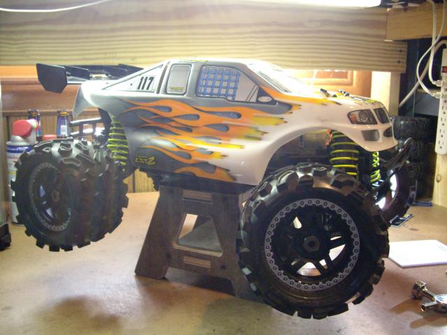

Here is my LST2 conversion I have been tweaking for a very long time. I am finally happy where it is at. Mods are:
TDR mount and single speed
RPM arms
Lunsford throughout
Losi FOC with gear swap
Losi hardcoated plates all around
Castle MMM
Castle 1717
Proline tires and wheels
17mm hubs
Dynamite carriers, spindles, hubs, steering, and brace
Losi wing
Zippy 6s batteries
There's probably a few things I forgot, but here are the pics.
Now I need to get out and run it.
-JB

clean looking truck. you didnt do anything with the steering slop?

Nice looking truck! I'm debating on getting an LST because of all the hype about them here lately--Josh

Thanks guys! The steering slop hasn't been an issue. I pulled out the servo savers and replaced them with standard arms. I also replaced the bushings on the draglink with bearings. That really tightened everything up.
-JB
