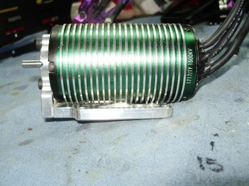

Since I bought another 1717 I thought I squeeze my 1717 Heli version into my DB-17 chassis. Hope this well help you fellas wanting to do the same ?
The 1717 Heli version is needed unless you grind one side of the can flat ?

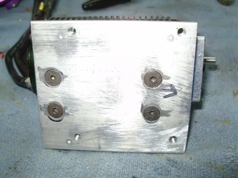

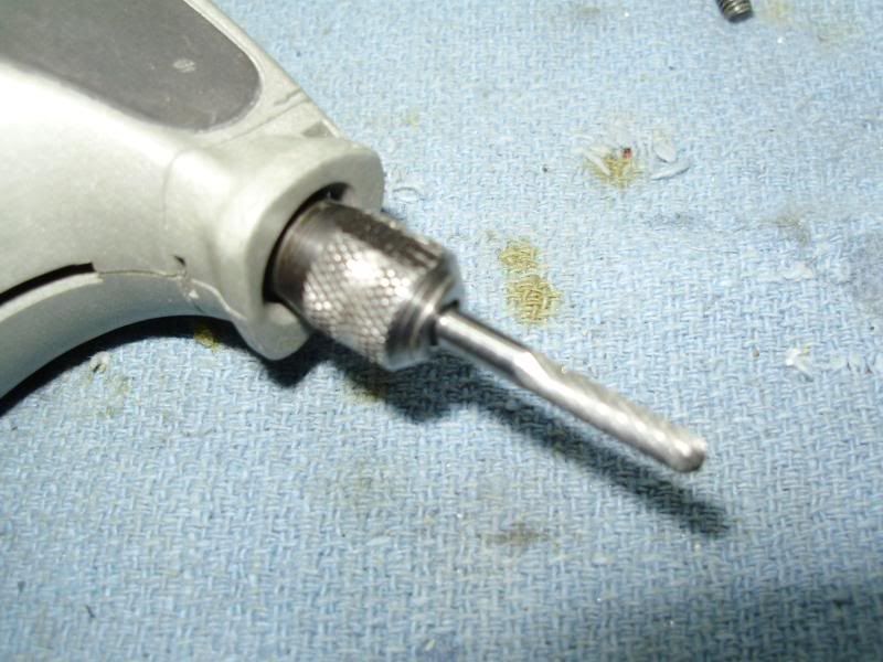

Use a dremel deburing bit to hog out the 3mm slots on a FLM or RCM Revo 3.3 Nitro conversion mount.
This is the gimmick I used and it made short work of the aluminum, a small round file will work but you'll be there a while.

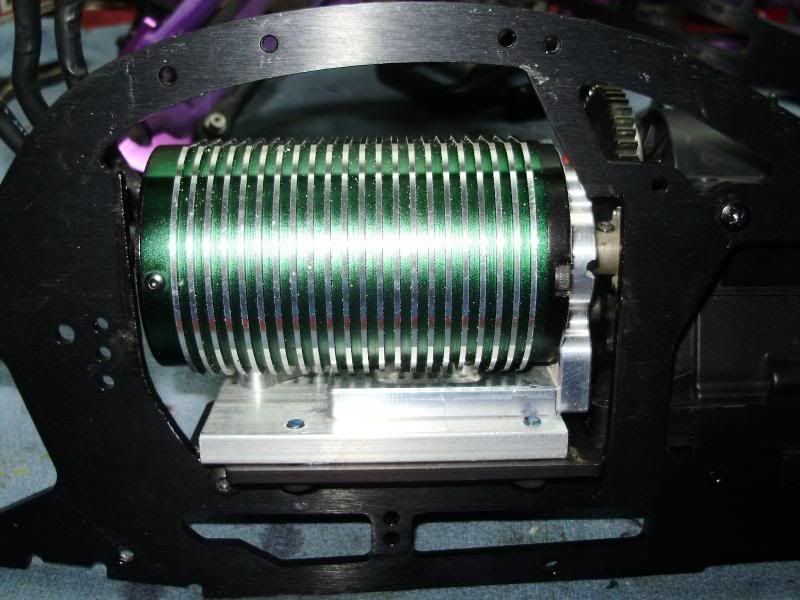

1717 installed

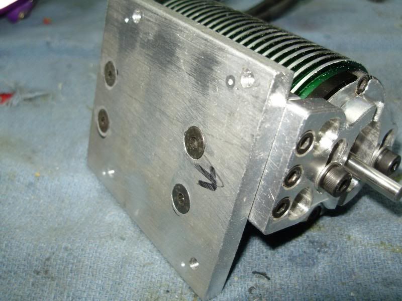

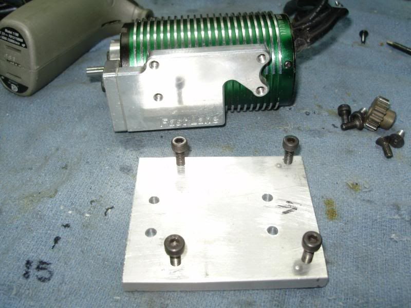

I then cut a piece of 2" X 3" X 3/16" flat stock and drilled and tapped holes (4mm)for it to be mounted where the original Flux mount went on the motor plate.

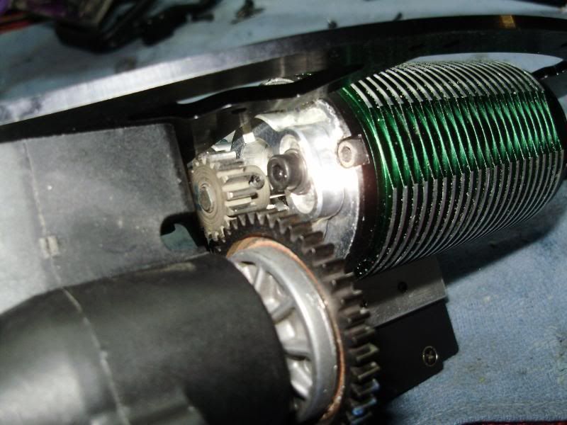

I then eyeballed where I wanted the mount to be on the tapped plate for optimum gear choice (I can easily use a 10T pinion up to at least a 18T with the way I've done this) I counter sunk the holes that the hardware attaches the FLM/RCM mount to the plate.
Then once all together I placed the assembly on the Flux motor mount plate and eyeballed where I needed to trim the chassis to allow the FatBoy 1717. I didn't have to remove much, it took a little bit because I had to cut a little reinstall, cut a little etc etc. After I filed the cut edges I ran over the shiney alum w/a black sharpie.

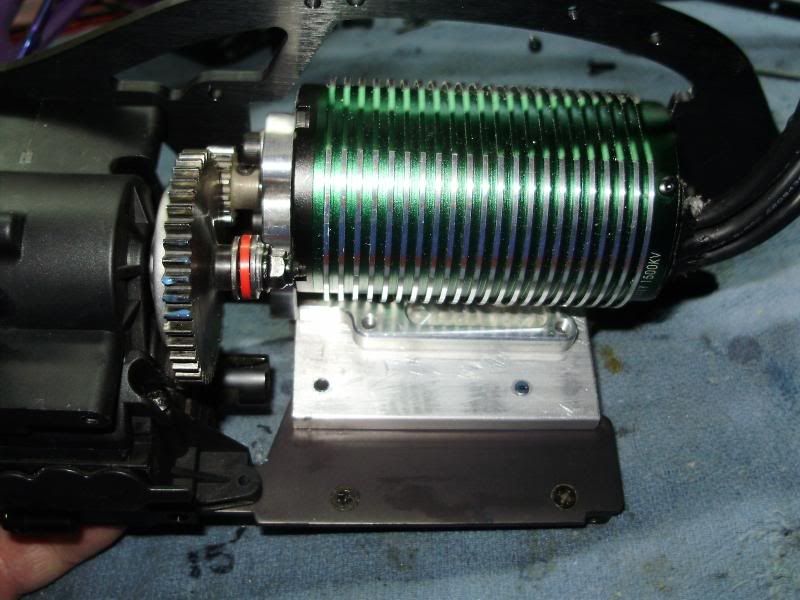

The draw back to stuffing this pig in here is I have to relocate the servo from the original FLM servo plate and reinstall on the side of the chassis rail but I'm not comlaining.

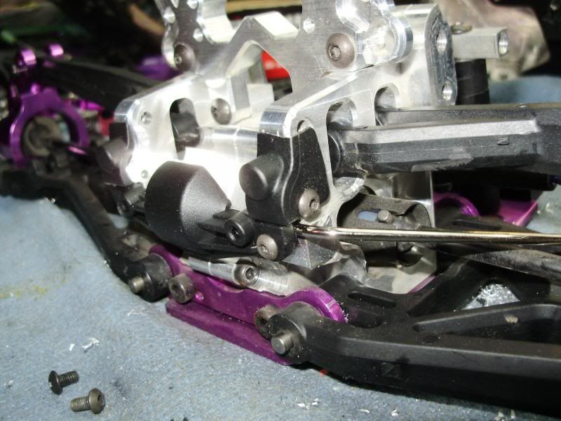

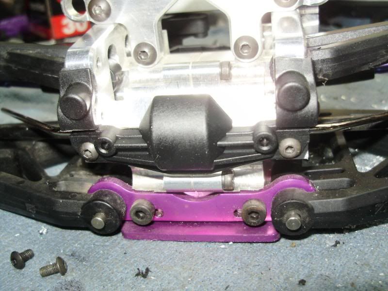

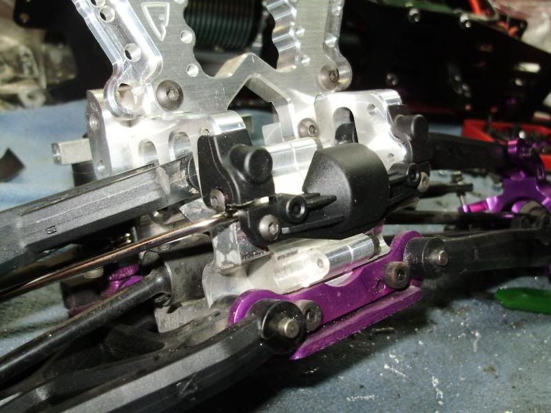

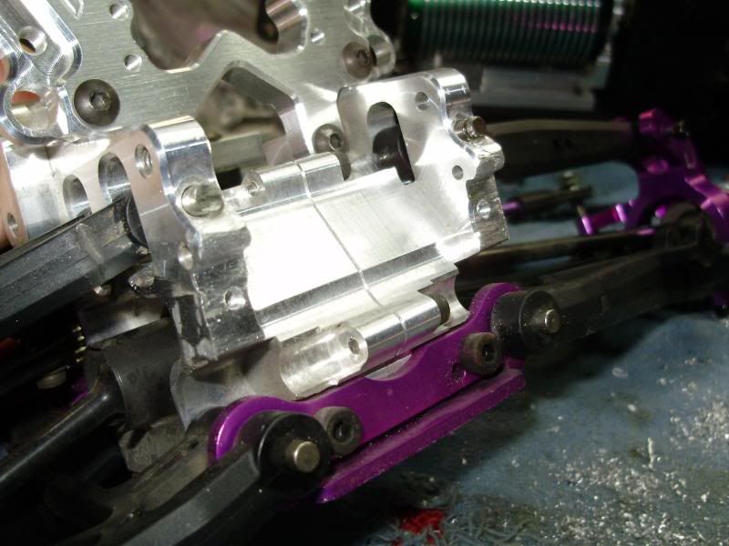

I had to do a bit of modding to get the sway kit to work w/the FLM bulks but it can be done with some patience and a 3mm drill&tap.
As you see I trimmed the front of the bulkhead down with a dremel wheel and hand file. I mocked the sway bar stay and marked holes, drilled and tapped.
Iwas able to use the little caps that are supposed to retain the upper arm pins, this took some modding also. I had to trim some plastic on 3 areas of the cap but it looks like It's supposed to after installation.
Just need to do the rear sway now, I hope this is the last of the stuff I have to do to this thing far as mods. Ben tinkering on and off for almost a week again and getting anxious to drive this thing. I also hope(I am somewhat confident) that the sways will aid the handleing quit a bit but we'll see I reckon ?

Nice work on the sway bar mount Bondo. Taking those ears off completely looks like it was definitely the trick - yours looks like it fits better than mine ended up. Now get this thing runnin!

you have a great project mate but what is the red part fitted to the spur gear if i may ask
JThiessen
JThiessen's Avatar
Posts: 2,436
Location: Edmonds WA
09.28.2010, 01:01 PM
Looks like a home made spring washer (rubber o-ring)????
