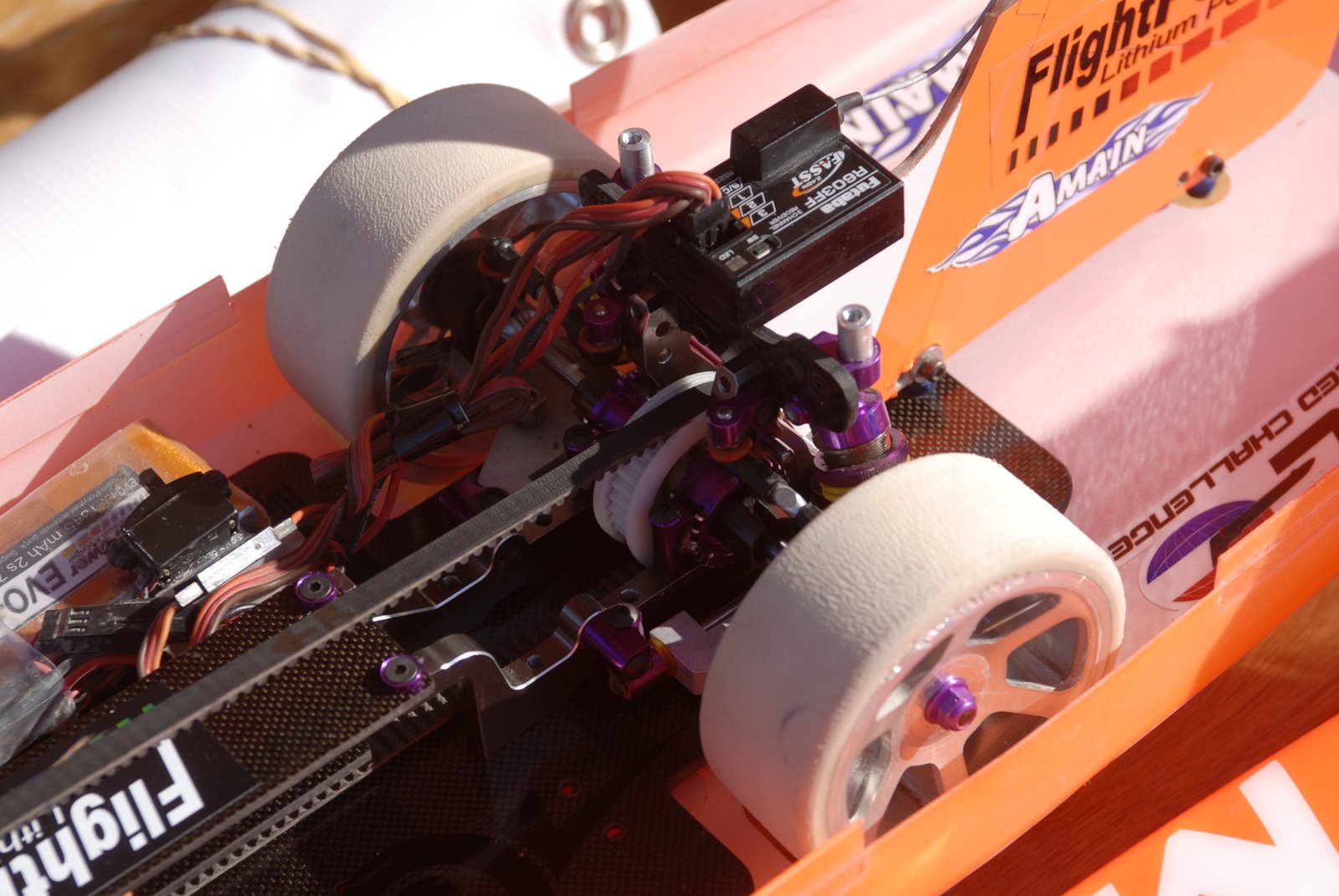

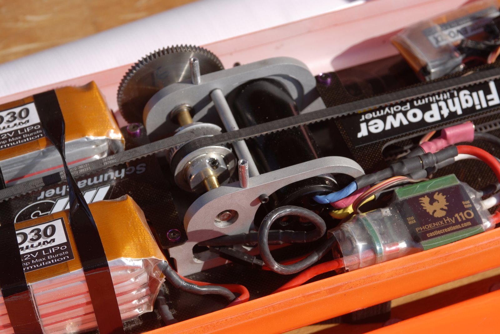

Looks like they signed Nic case, the stream liner looks like the same body shell, color and sponsors. Driveline looks based on the tc5.. But Im not sure how a belt would fare at those rpm's

No belts just a solid shaft

The power of a 1521 Neu motor, 12 cell PowerEdge Lipo battery, and the sophisticated power management of a Castle Creations speed controller, will be the propulsion of this wheel driven creation.
The Vulcanized tires are still in the making… The body will be the same CFD developed one as last year. The gears are the finest made – 32 pitch hardened steel, by RW. The radio will be the longest range I know of – the Fasst System from Futaba.
Here's his old car.
