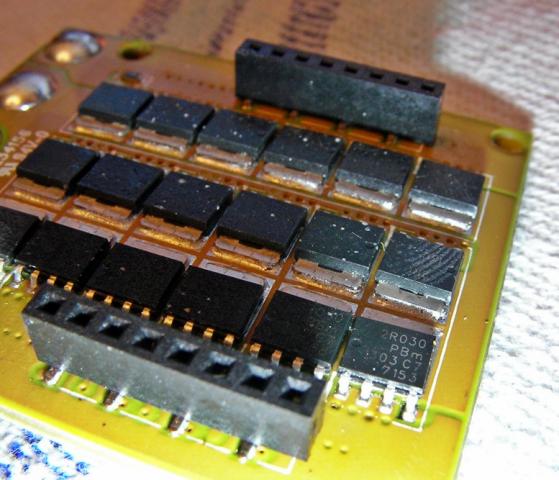

Would be great if somebody can read the specs of the FET.

I don't know what you mean with FET ( not a very good electric guy as it goes for names ) but on the brown one stands 6R8 and under that stands 6R8 to, but then upside down.

This is all I found based on the number I could read on the fet.
NXP 2r030

thanks for the input snellemin, seems to be quality stuff.

NXP 2r030
Middle-of-the-road FET.
About twice the resistance of the MOSFETs we use on Mamba Monster and Sidewider 1/8th.
