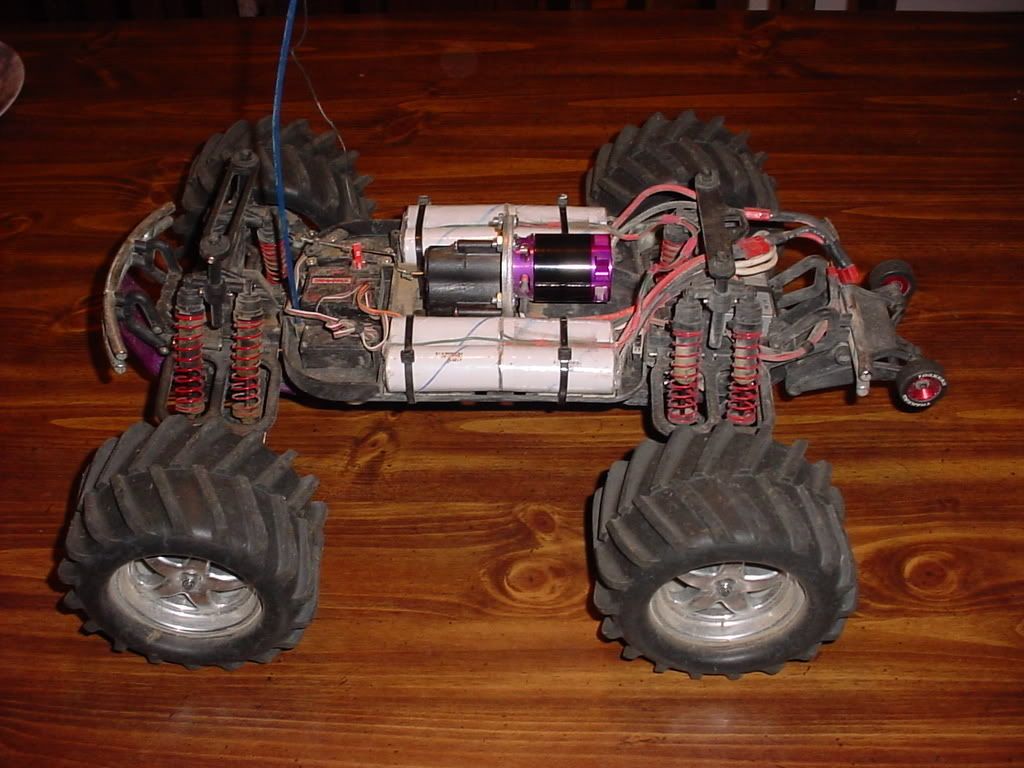

This is how I run 4S2P.
I have ran 6S2P but I think the stock motor plate on your setup might get in the way of that.

Thanks sikeston for the pic. I'm guessing you never take your batts out to recharge them? Still that give me a good idea of the size of the cells. I'm really diggin' the motor setup you have!

Hi Guys,
I'm using the Quark 80 amp ESC.
This setup was working really well for me. I had probably a dozen runs on it when I switched it over to 6S2P A123. I found the limits of the motor and the transmission on the first run.
It was VERY powerful. It was throwing rooster tails of gravel farther than I've seen so far, so I took it out to a paved road for some top speed runs. The ballooning stock tires were the limiting factor. I could control it up to around 55mph and I think it would have done more.
I drove it back in front of my house and was driving it pretty hard when it had a "come apart" LOL
The motor stator came loose from the bearing holder, twisting the windings and tearing wires loose. At the same time, I stripped the square center out of the drive dog in the transmission. Bummer.
Since then, I have put a new motor/transmission in it and put it back on 4S2P A123. This is a dependable setup. It will ride wheelies in 1st or 2nd gear and tops out around 40mph. I get about 20 minutes runtime per charge.
