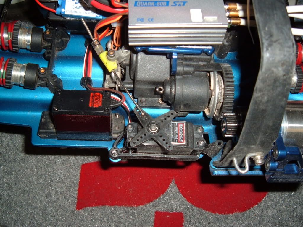

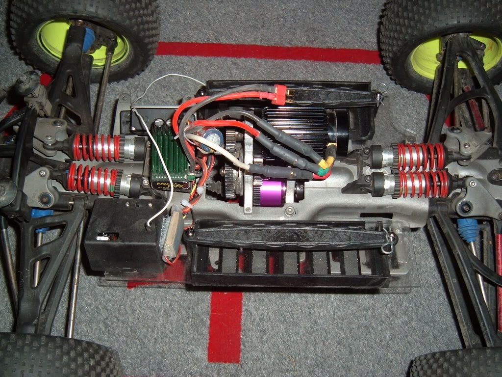

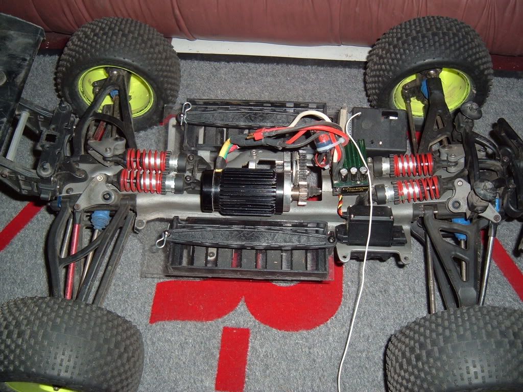

Here are both of my revos. Just finished both of them, and have a few runs on each. The first has the full Teknno conversion, an Aveox 2000kv, quark 80 air, 5s 5000mah lipo. Running a JR 9100t for steering and a futaba 3050 for brakes, off a y cable with the esc. The quark programs easy to just use the positve throttle range, no brakes or reverse. Currently have a 15/40 gearing, will step down to a 14t clutchbell as the speed is a bit much (radared at 44mph!). Way different than driving a direct drive electric, the clutch softens the takeoff. It will still wheely, just not as aggressively. I like the setup, just need better tires, the talons are a little soft for that kind of speed.

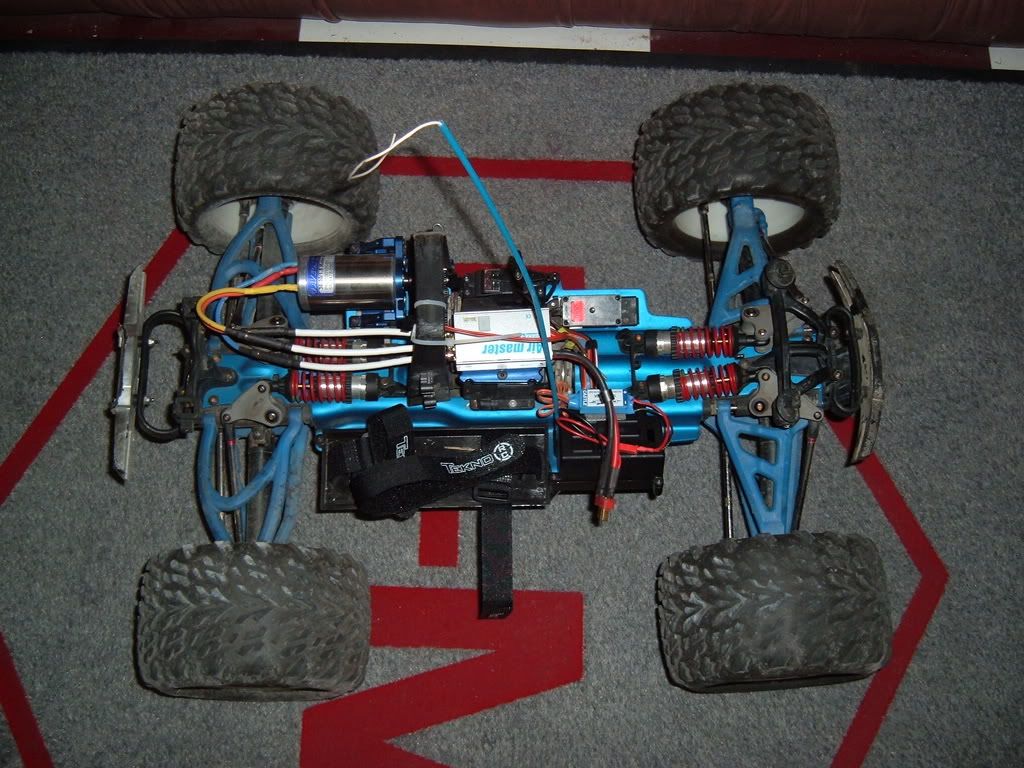

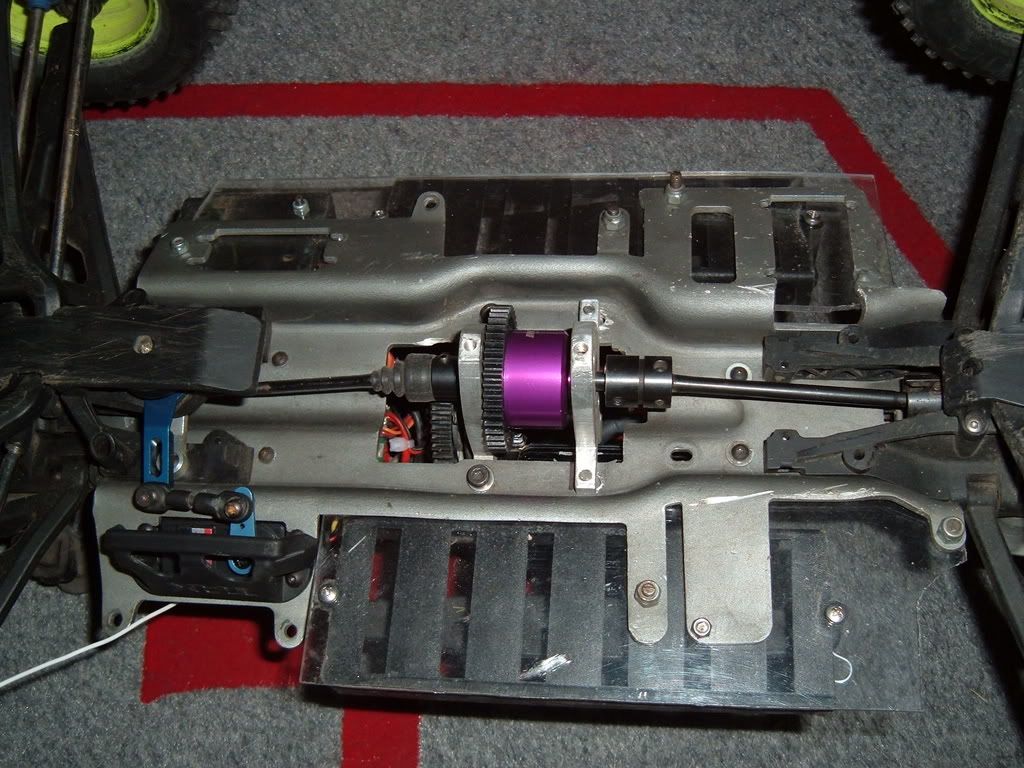

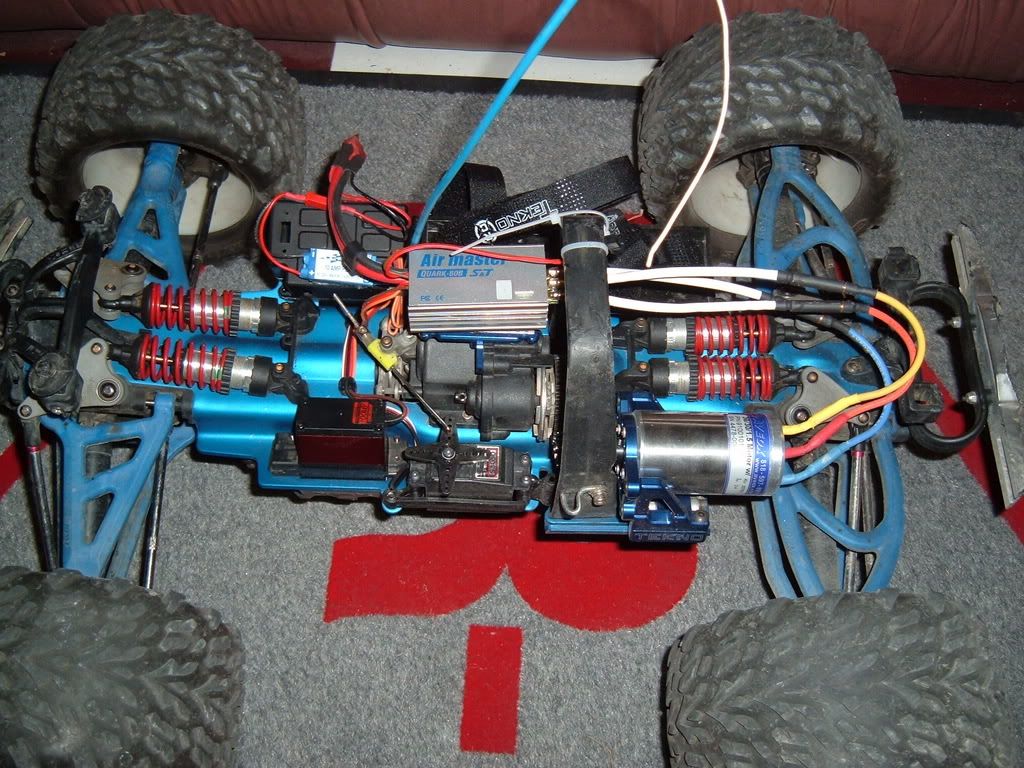

Here is the other Revo. It is Metalman's old revo that he built, I bought it off Mailman who got it in a trade. I did a few mods to the "slipperential" and added some lexan side guards and emaxx battery trays. Currently has a 7xl on a MM running 4s 500mah lipo. Has a hitec 645 for steering on it. It is a 3racing extended chassis that came out before the 3.3. It also has the extended wheelbase rear arms, so it is about truggy length. Runs good, but could do with better batteries as they are heating up a bit more than I like. The center diff really makes it turn well, and keeps all of the tires on the ground too! I cusom made the front cvd out of an emaxx cvd, just cut it in half and welded back to the length I needed.

Hey sike, Thanks for the kind words. I have only driven a nitro revo with the dual servos, all of my electric revos have had a single. The tekno revo with the jr servo is insane, I have the cc bec set at 6.5 v anf it swings the wheels like nothing, even hard on the brakes. I am going to swap out the MM in the slipper revo for a modded one that griffinru did for me. It does get hot when running the 7xl, especially with the current 20/40 gearing. I will also step up to 20/44 gearing, found some mod1 44t spurs that should work after some mods! Great deal on the MM combo, those 4mm plugs were loose on all of mine (7) and caused probs too, sell the 7700 motor on ebay, they go for at least 50 bucks, and are junk IMO.

your brake servo's horn on the first one is at a rather weird angle? is the brake predictable?
I can't get over the idea that it's odd to use a clutch on an electric vehicle.. It's adding maintanance and unneeded rotational mass parts.

Hey serum, the brake servo is setup like that cause I am using a Y cable to run the brake sevo and esc off the same channel. So of course the servo moves both ways. With the linkage setup that way it barely moves the linkage when the throttle is applied, thus making the brakes apply faster when going from full throttle to full brake. I have it set so that the brakes just lock up at full brake, and fell linear before that point. I had to play with the length of fuel tubing to get the right feel. I have a 3 channel which I intend to use to mix channels so that the servo does not move when the throttle is applied.
Now on the clutch topic, it is definately different. From a standstill, full throttle can be applied quickly and it does not instantly flip over. It will flip but the clutch does slip and it is noticable. With very small throttle input, the motor just spins, and you can gradually feed in more and make it move very sowly. Only down side is clutch temps. Like an idiot I touched it last night and burned myself! It was hot, more than a feigao after a 30min run
It is something different, that is all I can say. I am not a racer, but I have now run both a nitro 3.3 and this electric 3.3 and I can say that this is way superior. Not sure if that will translate to the track, but the setup does work. I have found that the largest gearing that can be used is a 15/40. That is the full adjustment on the motor mount. I am going down to a 14t clutchbell as this is heating up the aveox a little. I will say that it is tough, I flipped it quite a few times at 40mph and went into a ditch and various catwheels, nothing broke or shifted.
