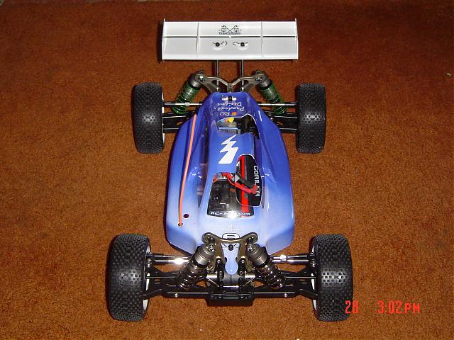

My new 8lectric pics:
ID:	3685   Click image for larger version
ID:	3686   Click image for larger version

Boy!!! Is that a 1515/1/Y/F in that buggy or what?
What kind of gearing and packs/voltage are you going to run?

yes on the motor
4s pn the V
Chapito
12.30.2007, 10:50 PM
Yes, it is!!!
I raced the buggy Sat. night. TQ'd and won the main. It is geared 13/48 and I am running 4s lipo. First qualifier I ran a Poly RC 3700 for 2 hot practice laps and 5 min.s; finished 2nd and used 1569mah. Second qualifier I ran a firefox 3700 for 1 lazy practice lap and 5 min.: TQ'd and used over 1900mah of battery. Main I ran a Enermax 5000, 1 hot lap, 5 min. main, Won and used about 1650mah of juice. Temps were consistently 110-motor, 105-Quark(without Hautz's heatsink), and 90-battery except for the crappy firefox which was down to 115 from it's normal 135 range. It wieghs in somewhere between 8.5 and 9 lbs depending on which battery I have in it but was generaly well behaved and probably had 3-5 m.p.h. more than the fastest nitro @ the track. Also, it is super smoooooth compared to the Truggy.
I am very pleased with it......
