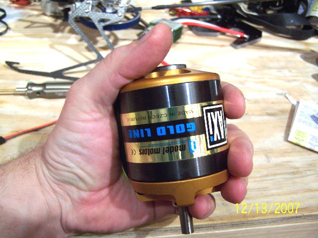

Hey Guys!
Check out the new AXI 5345 I just picked up off Fee-Bay new in box for $180.
This is not for a monster truck project, though. It is actually for an E-bike conversion I am building. But, I thought I would show it to you guys.
This thing is rated at 93% efficiency at 50 amps and is capable of 4000 watts continuous and 6000 watts peak! Not bad for $180.
I have a smaller AXI in a scratch built truck and I love it. If this motor proves to work well enough in my E-Bike (should be a rocket), I may have to pick up another and start a truck project based around this motor.

that's nice.. 93% @ 50Amps.... hwo many cells can it do..?

What's its kv? I know it's going to be 225, 195, or 171. I too am curious what voltage you'll be running.
12.14.2007, 01:15 PM
Hmmm. 4kw at 50A would be 80v. 21s lipo or 66 NiMH cells or 24s A123s?

It is good for 12S. This motor is 225 KV.
It is rated at 4000 watts continuous. At that 4000 watts, the efficiency drops to the high 80s. Still it is ggod for 2500 watts at that 93% efficiency.
At 6000 watts, the efficiency obviously goes down.
I will be running 12S 10,000 mah through a HV110. :)
Should be fun!

what is the advantage of running 12s in this system rather than 5s on a 2.5d?
i just probably first ask what kinda truck its going in?

It is going in an E-bike.
12S will give the most power.
I have a similar AXI in a scratch built truck on 6s and it is fantastic.

theres no way that little motor could power a 1:1 bike... or so i wouldnt think.......

What is it they say? "Size doesn't matter?" (It does make at least a bit of difference, by the way).
Yes, this is for a full size bike, a recumbent.
A typical man has the potential energy of roughly 200 watts oof power in his legs. This motor is capable of 4000 watts continuous. If you do some E-bike research, you will find that typical E-bikes run about 400 to 600 watt motors and those motors are 40% to 60% efficient. This motor will put out over 5hp continuous. That is more than a 50cc scooter.
Anyway, I know this is an RC forum. I didn't mean to confuse anyone. But, I figured you guys would get a kick out of it because I am using all RC equipment for this project.
