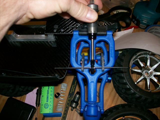

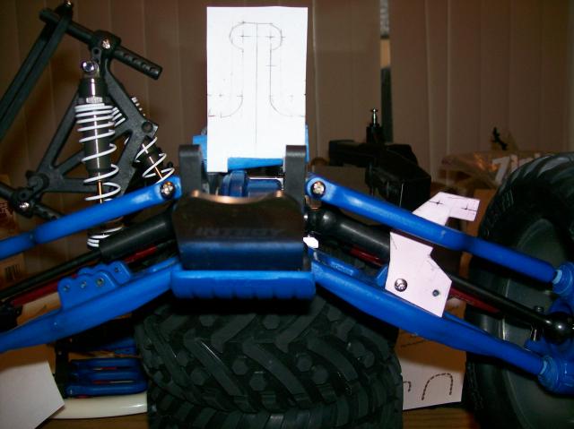

Hey all , need help and some opinions. Im stuck waiting on battires and charger $$ low, So I figured I would start working on the suspension set-up. Here's where I dont know which direction to go. Option #1 to get 8 better ofna shocks like U.E. ones and remake shock tower out of aluminum and keep geometry pretty much the same. Option #2 use 4 losi eight 2.0 rears and make like pictures posted. Forgive me pics arent that great. I was thinking that the losi shocks would be a much more smoother and more stable but alot more work.

The only issues I see are that the lower mount extensions might be sort of flimsy unless you made a piece to bridge the F & R mounts on each A arm.
And you'd lose your body posts unless you came up with a way around that.
I think aesthetically it would be better to go with the 8 shock plan...

I like it! One thing I would do, though, is machine another rear diff riser block so that it captures the lower hinge-pins...

Thanks guys for the feed back. Chad thats a good idea im going to have look into getting longer hinge pins then. Red you are right in line with what I was thinking. I was going to make 2 of the extensions in carbon fiber to sandwhich the top peice made out of aluminum, to center the shock. Im still kinda up in the air if I should go any father enjineering this method, like you said Red about the body posts and the fact is there going to be a benefet. This way it does bring the shocks up higher which brings the COG higher, but you do lose some weight going from 8 shocks to 4. Some times designing your own is kinda a drag, you spend days sometimes couple of weeks just thinking is this a good direction, am I missing anything, should I try it this way................. Well again guys thanks for the info i'll keep you posted

Losi eight shpcks are good but you may have a bit of trouble getting stiff enough springs for them - its easier to go the 8 shocks route verses the 4 eight shocks if you know what I mean

"Red you are right in line with what I was thinking. I was going to make 2 of the extensions in carbon fiber to sandwhich the top peice made out of aluminum, to center the shock"
Well, sort of. I was envisioning the dogleg exts. being offset either F or R, and tieing them together below the upper A arm. The body post mount could then be offset the opposite side to retain your post centerline. With the oversized wheels I really think you need the extra control of two shocks.
Your idea would certainly score big points for uniqueness, but I lean toward that being MTTIW honestly. And you don't necessarily have to run 8 springs either as I'm sure you're aware. We'll just have to see where it goes!

You could also adapt a set of Revo rockers and make inboard shock mounts

Revo style, I like but wouldnt really work for my appplication. I decided to go with an 8 shock ofna set-up. I think there a larger bore size than even the U.E. shocks, which does anyone know the bore size on those? I also have coming my G.A. bulkheads coming. So once i get shocks and bulkheads in hand Im going to start working on shock towers.
