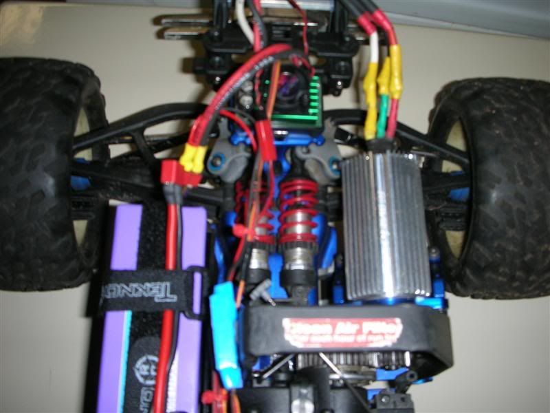

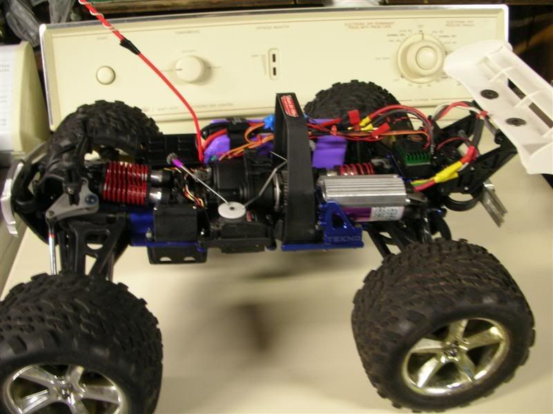

Im pretty pleased so far. Im working on posting a video right now. just ran it for about 5 minutes.......lots of wheelie's
I also did a few high speed runs but none on film.
temps seemed to be fine.
motor and esc around 100

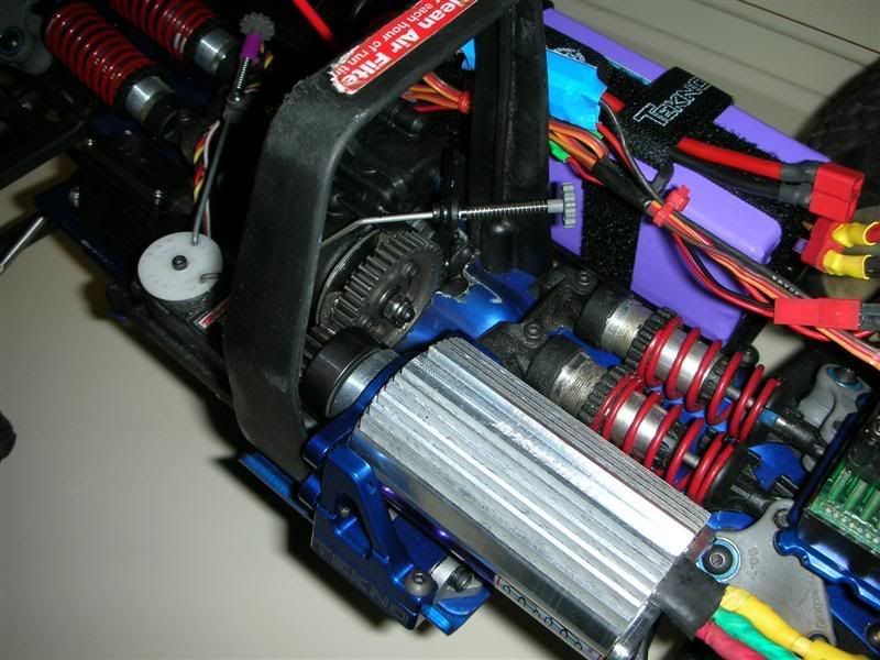

Having a heat issue though.
4s 8000 lipo................................100-120
mamba max esc (w/fan)..............150-175
Feigao 7xl...................................200-225
im running a 40t spur and a 15t cb
any suggestions on changing gearing??
Im hoping the 8xl will help with temps.

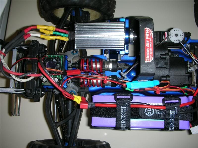

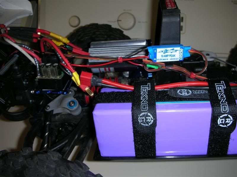

How is the side to side weight balance with that huge battery on there?
