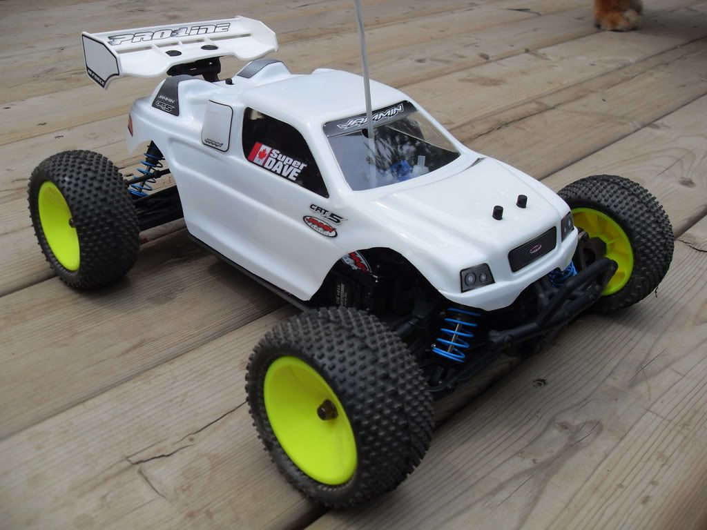

hey guys you are rite this is way to much motor for this truck, hard to get a smooth lap in. i will go with a small kv motor maybe a 4600 or 5700 and still run 2s packs, this is a extended chassis kit new fomat for this kit. please give some help if anyone else runs a motor in this kv range 46-57. this is just something to have some fun with not to be just speed demon thanks guys the top plate i cut from a sheet of carbon fiber and same for the recieve, monster mike is currently out of stock on the chassis kits.

Don't often see any higher than 4600kv motors used in the CRT.5, the VXL (3500KV) seems to be a popular choice. Tekin also make a brushless motor called Redline which do a good range of KV motors

I run one of the faster motors a 7L a few go with the 9L or a 1509 would go in there very nicely

Believe it or not I run a 7.4 volt Novak GTB and 6.5 (6400kv) Velocity motor in my e-crt.5 with truck tires. It runs great geared 12/46 with out any heat issues even in racing. However, I do wish it had a bit more grunt. I'm thinking 11.1 volts with a MM and VXL motor or maybe one of the 50mm Medusa motors.
