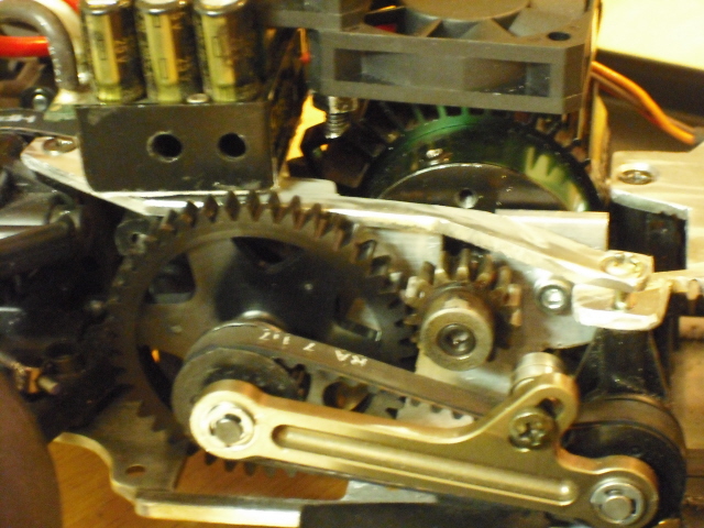

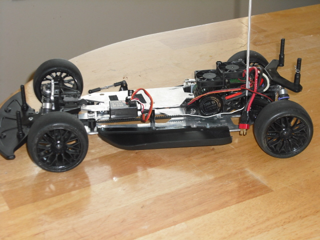

Still got a few things to do. Took her to the track today. I need to secure the motor mount better and build a battery tray for top plate. All in all I like it. Finished cutting out the Lamborghini Diablo body...no paint yet.

Nice job, looks clean.
I guess the super RS4 was in between 10th and 8th scale?
