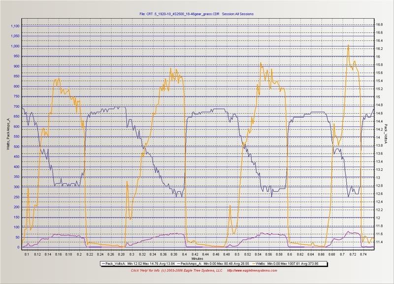

I got some ET data for some of the spd runs. Same setup as in the vid, but no radar, but spds are about the same. What is interesting is that the amp draw and wattage is so much lower than when I had mashers on with much lower gearing. Top spd then was only 50 on even with 1400W. Barely a 1000 and it pulls to 60. I could prolly even gear up a bit for a few more mph as I know the setup will handle it.

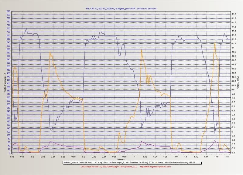

Here is some ETs for 3s. Top spd was 50mph, Again, amps are pretty low.
Also, notice the little voltage spikes after the big drops from the spd run? I think that is from the motor braking. The graph shows a hard accel from a stand still (ramping up the thr gradually as not to flip,) finally WOT (the big spike halfway thru the peak,) wattage/amps tapering off at full spd, then thr release and coast for a few seconds, then motor brake to stop it. Then repeat. Cool

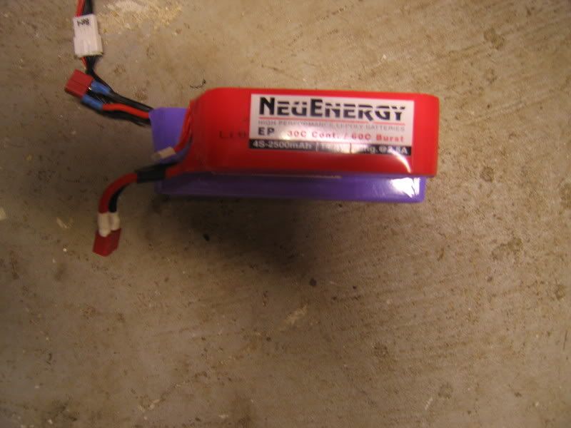

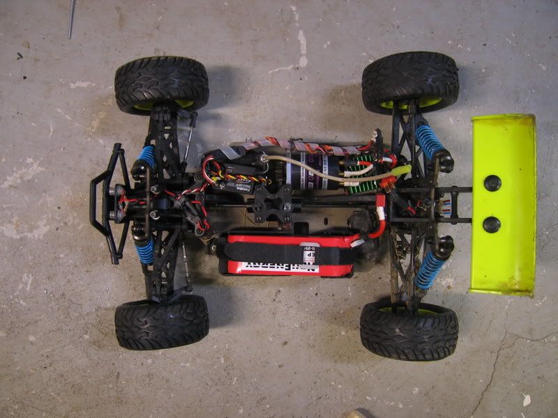

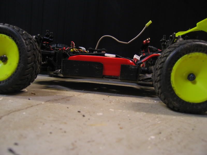

Pics as requested. Couple notes: The tray came apart at end of 60mph video. I used an ABS cement to put the tray together, but it didn't bond well to the plastic. I redid it w/ Gorrilla glue, but rear tray shifted during drying and backend sticks out too much from the side. Fit snug first time (see 1st pics in earlier post) and only over hung by ~2mm. Need to fix this, but, eh works for now. Pic makes the repair look worse than it is tho.
Basically the tray is the project box quartered, slimmed down to 35mm wide, and a single strip of ABS attaching all the quarters together. Thin padding foam from T2 batt tray runs the length. 2 3mm from below, now 2 3mm from top bolting all quarters down for extra strength.
Top w/ batt:
3s batt from side:

Comparing 35mm wide batt to 44mm ("1/10th scale") batt. 35mm batt is shorter and less wide but taller. Fits better on OFNA chassis IMO.
