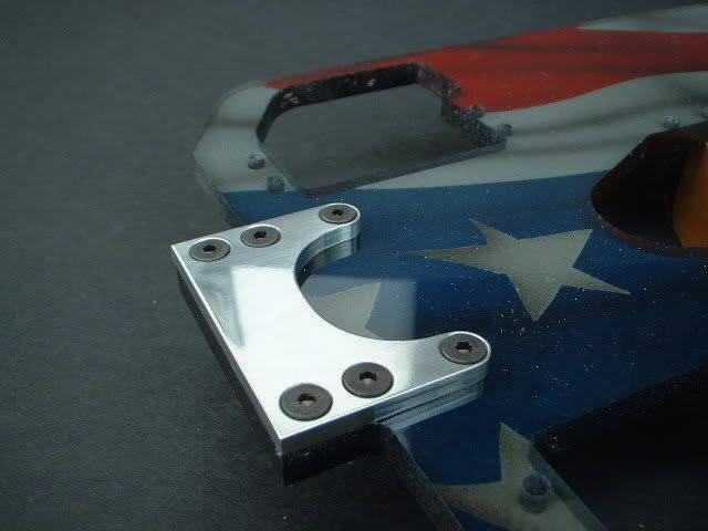

  (#60)
01.08.2009, 10:36 PM
and it goes a lil' somethin like this!
