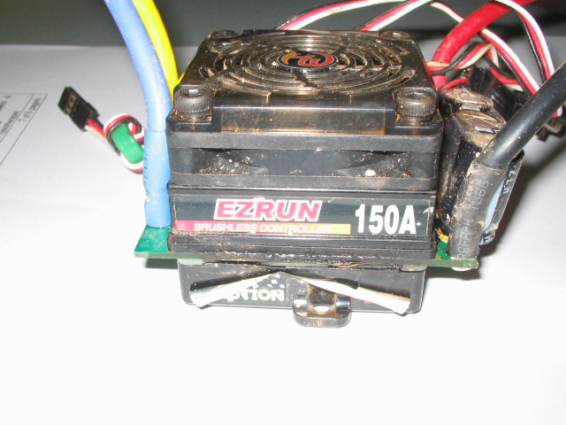

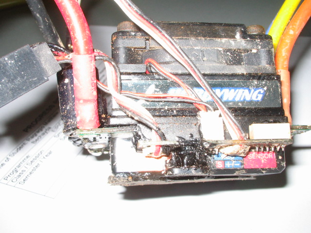

this is how it looks like BBQ
ID:	6671   Click image for larger version
ID:	6672   Click image for larger version

littlegiant
Posts: 165
Join Date: Mar 2009
03.26.2009, 05:45 AM
Originally Posted by superek4 View Post
u should ask me, mine was destroyed when set to 1.anyway I sent mine for service n most prob will get a replacement as mine was burnt. Will post pics later
Sent it to HW straight or through your agent for a replacement?
superek4
superek4's Avatar
Posts: 832
Join Date: Jan 2009
03.26.2009, 06:44 AM
I sent thru agent safer n can pester agent
