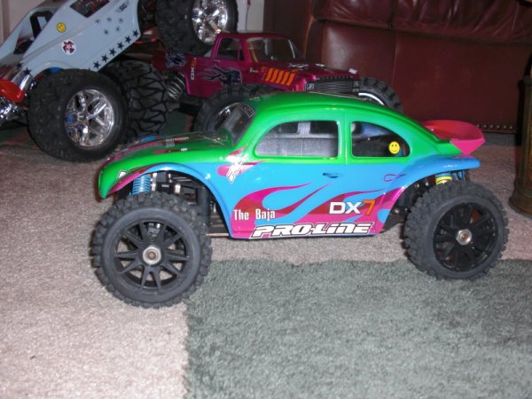

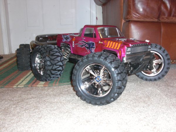

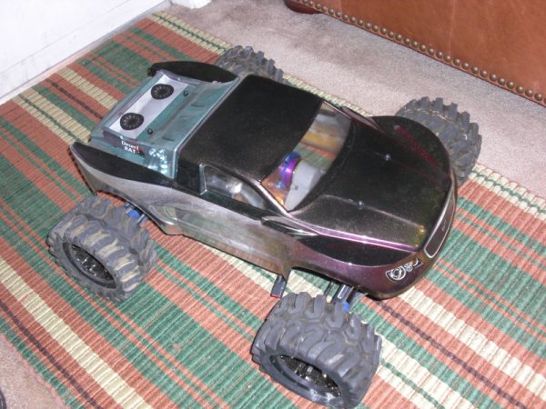

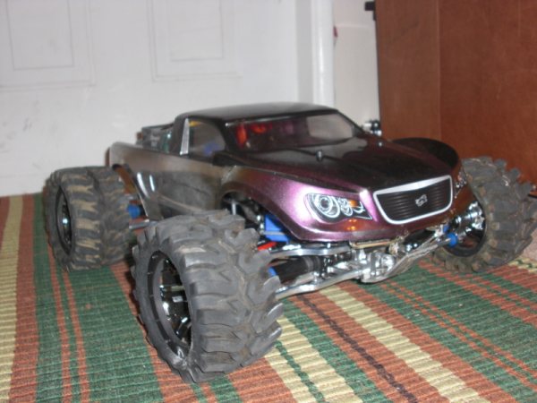

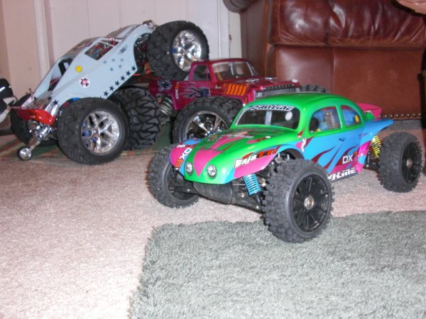

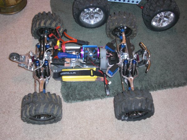

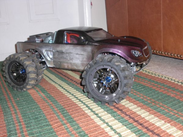

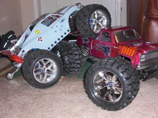

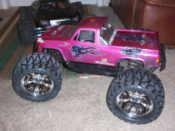

Here's some pics of my setup (plus a couple of other rides). I've added a fan/heatsink that just arrived and tried it out this morning on 6s again. Very impressed with the temps (112 motor, mamba max 123, batts 96). I did go with 40c Rhino packs and used 10 ga wire on my "Y-connector" for the batteries. Previously 12 ga and 30c Zippy packs before. Packs were always at decent temps but "y-connector" was a bit warm.
Yes, good looking ride! Thanks for posting.
What's your gearing? Is that a 11XL?
I didn't know that heat sink would stretch that far. I have one exactly like that. I may try it.

Thanks! I actually have the 10XL, sorry for the confusion. I travel a lot for work and usually have tons of time to imagine what rides I'd like to build but not much time to play with them. Lotsa online ordering and stuff, so sometimes details are missed. Happens to us older guys! BTW, that heatsink works really great. I took two vise-grips and pulled it apart a little to make it fit. Besides goin along with the color scheme and still leaving a bit of the motor to show through, it kept my temps down a lot. I ran again today for 16 mins motor 127f, batts 119f and esc was 135f.
