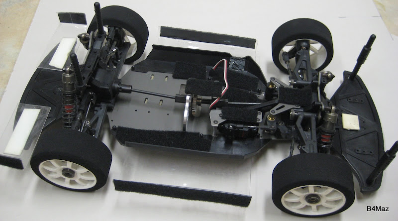

Try Stock Drive Products. They have many gears with 5mm bores.
The spur gear in a RC8 is a problem. Its difficult to find a custom size. I was lucky in my OFNA GTP. It has a spool (no dif) its just a 8mm shaft. So all I had to do was find a spur gear with a 8mm bore to fit. I wonder if you would be able to fit a OFNA spool on an RC8 so it would be easier to get a small gear on there.
