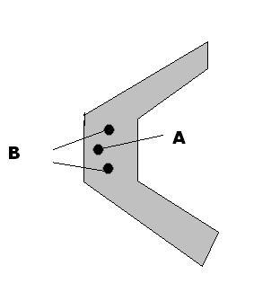

4-5mm would probably be too far back for many diffs - there is less than 4mm difference between most diffs and a 3.3mm hole that is 4mm offset from another 3.3mm hole is practically a slot. :)
Hmm... yea, I'm not sure how much shorter your slipperential is, just a guestimate based on the pix and the shim recc's.
The other idea would be to make a second set of mounting holes offset from the first. It would be a bit more of a pita, as the F diff mount would need more work, but could span a range of sizes from the long diffs, to shorter ones like the SlipDiff w/o tons of shims.
IDK, just a thought. I'm sure you will come up with something clever. :)
Here's a crappy pic of what I mean.

The easiest way to modify would be to simply shorten the legs on the existing top plate - I made the legs long enough and drilled and tapped the holes deep enough to allow this as an option. If you remove a known amount and move the mount holes for the front the same amount on the template, you have a smaller package that fits smaller diffs directly. :)
^^^ and that would be it lol
