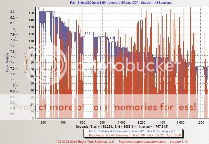

I got the 150 amp version of the Data logger. I've been running 13/54 gearing with my Trenchers for 45mph on 2s, with the 3800.
Well, I maxed out the 150 amp version. This little motor can draw some amps. I'll be gearing down, and running the 2400, just for comparison, but uh, yeah it can sure handle some power.

Nice Asheck. Don't worry about maxing the logger out. Mine goes above 180A. Ofcourse there is some err in the readings, but it's capable.

By how slow the 11/54 felt, I was kinda surprised the amps didn't drop more. I haven't tried any othe motors in this, maybe the motor is just amp hungry, though the temps are always good, so it must not be wasting it.
Yeah, but I really have to wonder about the err. It seems my 100 amp was off before it got to 110. I was hoping the 150 would at least be good enough for my small vehicles.
