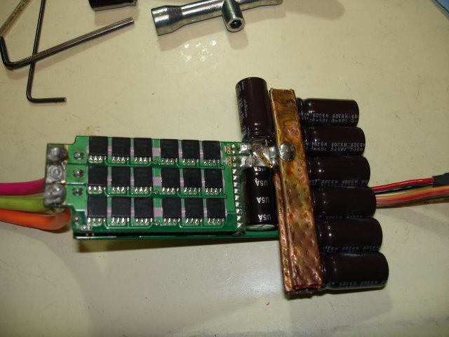

U should have looked at my thread PedeBeater, these guys said the exact same thing....
anyways here is my capacitor board

Here is what i did last summer with my Quark 125.... It's very overkill I know, but that thing could handle ANYTHING i threw at it, massive over gearing, you name it.
