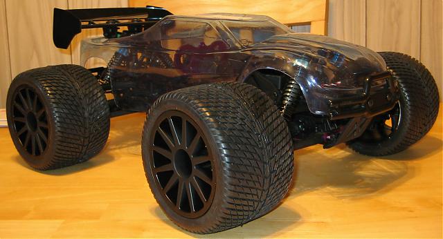

Hey guys,
I'm new to the site, but not to R/C. I've heard great things about this site and wanted to be a part of it.
This is my E-Savage running:
GCMachine RoadBoy BL chassis
SuperGlide ball-bearing steering setup
HPI Hellfire wing and mount
HPI E-Firestorm CF shock towers (doubled up)
Proline 40 Series Wabash rims (painted black with Krylon Fusion)
Proline 40 Series RoadRage tires
All bearing has been cleaned and lubed with synthetic oil... Smooth
Diffs all shimmed and tight
JConcepts Revo 3.3 HD Illuzion body
RPM E-Savage bumper mounts w/ RPM Revo black bumpers
Hope you like it.
Trying to decide on what motor setup to run. Any input would be greatly appreciated.
Can anyone tell me if running two 13X3 and 8 cells... will get this beast going at a decent rate?
-ST

Nice truck.....I cant answer you on the motors thou...wait a few more minutes and the rest will come...
Welcome to the forum
E-Slayer direct drive to diff

Welcome to the forum Satayo!
nice looking ride, why didn;t you picked the phaltline tires? you could have dyed the chrome black on these tremor rimms.

do you have a budget? if you can afford $250 I would go with a Neu..with a Savage you could go with a 1515 can the windings depending on the voltage you will be using...some have used a 1521 but I would stay away from that unless you are prepared to invest in drivetrain upgrades especially diffs

I picked the Proline combo b/c that's what I had... I like the Phaltline setup but used what I already had... might try them sometime.
azjc,
As far as budget goes... if I'm going to spend around $250, I'd like to get a motor and speedo to run it for that price... thanks for the suggestion, I'll keep it in mind.

How about the 1515 1y on 5s with a MMM? Might be out of budget, but it would scream. (A screaming savage)

than a Medusa or Feigao are your options with a MMM

I'd recommend a Feigao 10XL on 5s lipo with the MMM, for a fast 40-45mph setup. That motor and speed control would only cost you $260-280.
