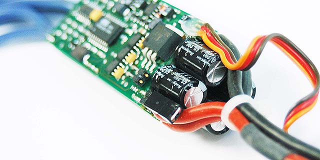

I have not found any burnt element or loose items yet... I however saw a little dent in the back of one capacitor, not sure if this will be causing the trouble.. I think this happened during the crash too, not sure though... You can see the images below..

The boards look fine... every tight...

Some more clips of the BK... There is another pic below that highlights the suspected Cap..

can't make out the details but the jumper pins to enable/disable BEC looks a little desoldered

Hi Joe Ling, All both jumpers are still solid... I can't see any crack or broken solder on the board... Sorry for the bad photos though...
Do you think the little dent in the CAP can cause the BK act up?

pehaps, how hard would it be to replace it? if its easy i guess you could try replacing both of them with suitable ones or perhaps bigger ones!

The caps did not change anything... Do you or Anyone else have any ideas? I don't want to just loose the controller...
