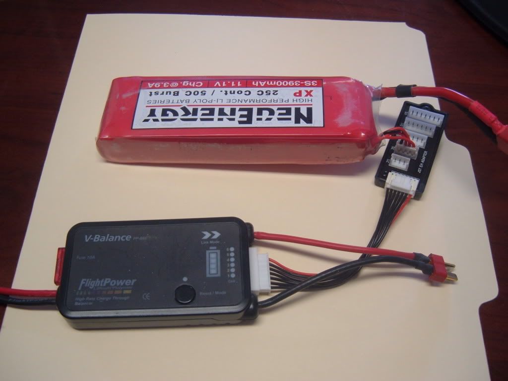

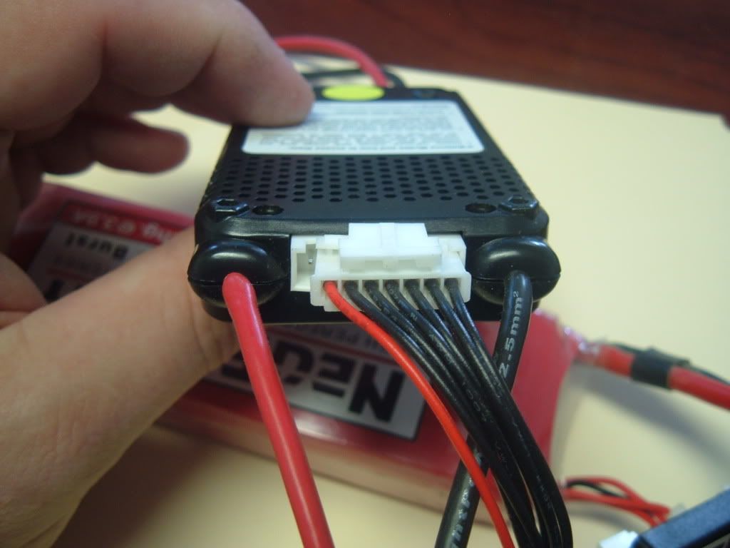

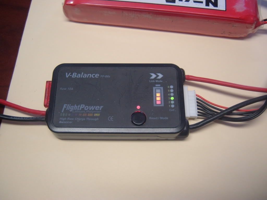

I was up to 3am, went to the Metallica concert last night and got home late.
Here are a few pics. I just plugged the adapter harness in and left the 8th pin (closest to the pos charge lead) exposed. Works fine with a 3s pack, I do not have a 5s pack to try.

11.25.2008, 12:17 AM
Well it doesn't fit without the adapter board....

It was a decent show, quite long. Their light show was good, but it had a bit too much light shined in my eyes...
Yeah, the spacing is different, huh? Gotta get the adapter board...
