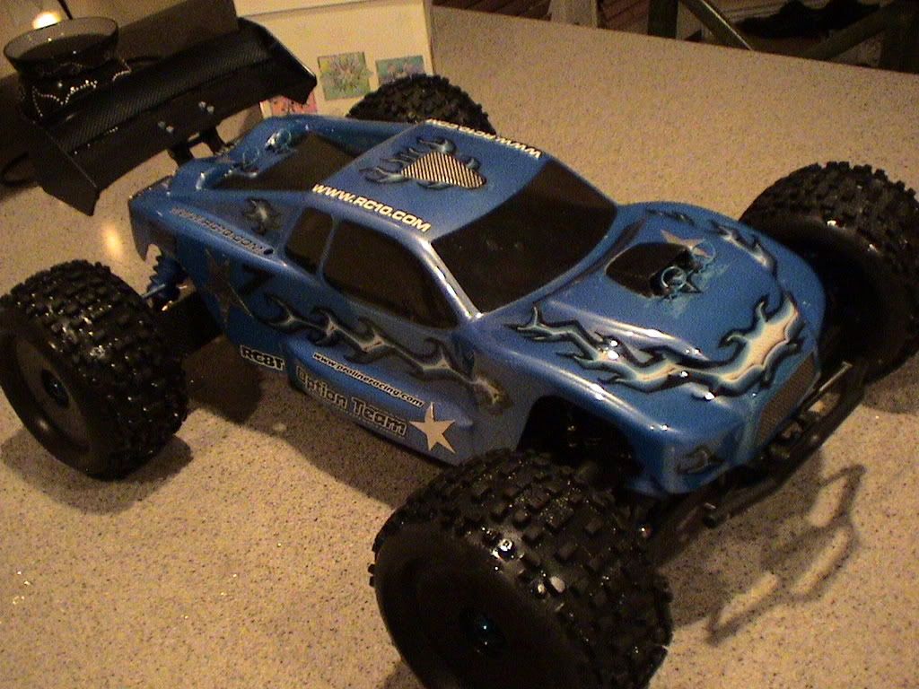

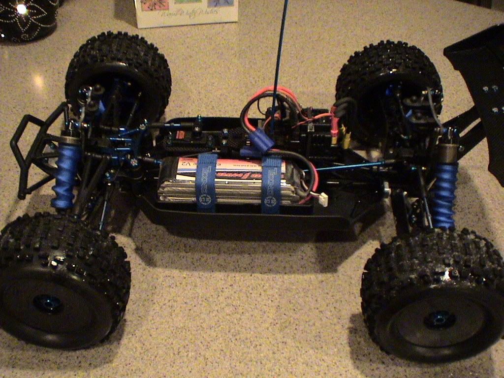

so here is the history of the Carbon RC8T so far.
version1: 5mm Carbon chassis. looked badass but jumped like crap cuz the chassis was just way to stiff. super silent setup due to sound/vibration absorption by the thick carbon
version2: 3mm 7075 alum chassis. this ran pretty good overall. add lots of weight though since i am not able to mill the chassis and it didnt look that great. it sure did jump better though. much louder than the carbon chassis.
version3: 3mm RCM chassis and RC8T brushless conversion kit. sound is inbetween the carbon and my own alum chassis. sounds good. neither quiet nor loud. esc is not ideally mounted. and worst of all - no mechanical brakes. better than version 2 in quality in appearance but lack of mech brakes is a big hit.
so needless to say there will be a version 4. i hope to nail it with this one. have you all started to get an idea of what a perfectionist i am? or anal? whatever you want to call it. anyway, version 4 i am just going to go all out. its going to be a carbon chassis, 3mm this time in hopes of some flex for good jumping and, the front kickup will be there cuz i will fuse the front end from the stock chassis to the 3mm carbon one. also, all cuts, milling, and holes i am going to have professionally done with a CNC. it will take some time and money but at least i will end up with the Rc8T i set out to build. or at least i better or i could be very upset....
version3 pics (water droplets cuz i just finished a killer snow run)

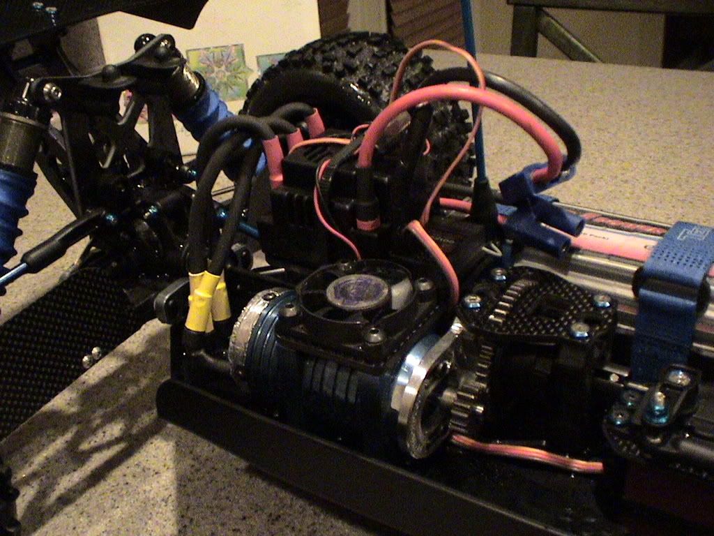

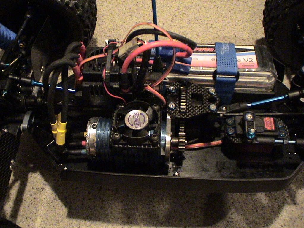

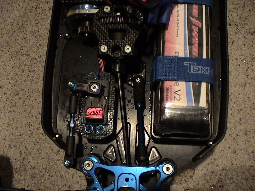

here is the build pics of version 4 as promised. still needs some adjusment though. because the center diff sits so high off the chassis with the RCM conversion i had to use 3 shims on the servo stands and 1/8" of spacers on the servo arm and the servo still doesnt sit high enough. so i am going to somehow try to make the setup work without the huge center diff shim.
i also had to use a Tekno long shank pinion after making the spacer so that the motor can didnt rub the brakes. anyway, the pics tell the story for the most part.
i also move the esc behind the battery. looks much cleaner.
v4.15
v4.14
2 pices of 3mm carbon glued together for a 6mm piece. just enough to clear the brakes now. one side had to be ground down to clear the brakes. 2 screws hold the piece against the motor and the other two screws hold themotor to the mount.

a couple more pics. the things seems to drive great now. havent been able to test on track yet but will soon. love the mech brakes finally.

Aluminum may be a better material for the brake spacer because it is thermally conductive - as is the motor mount. CF won't transfer any heat, so your motor might run a bit warmer than with an aluminum brake spacer.
Here is something else to consider: you could use a smaller servo for the rear brake only to save weight, and then mix in motor brakes since the motor brake tends to get transferred to the front anyways (this is what causes these conversions to push with motor brakes only). With this setup you can tune the braking from your radio without messing with any linkages. It's just a thought, and this is the setup I am using on my 1/8 buggy.

so this weekend i had it on the track finally. it did seem to run hotter than normal. after 20 minutes of hard driving my motor temp was 144*, esc was 135*. this is on an indoor track so ambient temp was roughly 70*. this is alittle warmer than i like to see so i may try the alum suggestion but i dont have any thick enough right now.
i have made some adjustments since the last pics. i got rid of the center diff shim so that the brake servo lines up without all the shims and also this really lowered my CG. i am able to run 13/46 gearing now for less rotational weight.
the thing drove amazing at the track. after a few suspension tweaks it was perfect and absolutely nobody was even keeping up. there was a lot of interest in it. hope this spurs others to build their own 1/8 conversion since it is in its infancy here.
