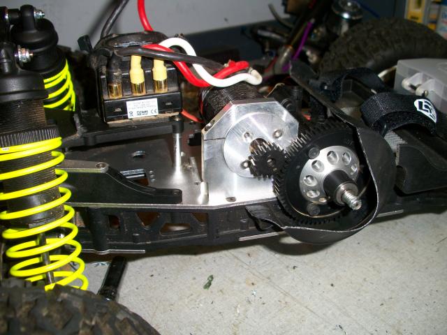

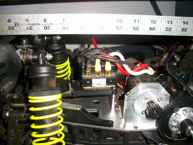

My new big guy,cant wait for the bigg green guy
bryan
bryan's Avatar
Posts: 489
Join Date: Jul 2009
Location: maryland
My new big guy,cant wait for the bigg green guy - 08.26.2010, 07:45 PM
What do ya think about the esc. location? There is almost an inch from the top of the esc. to the shock mount.It should get better air flow sitting higher than the "temporary" motor.
