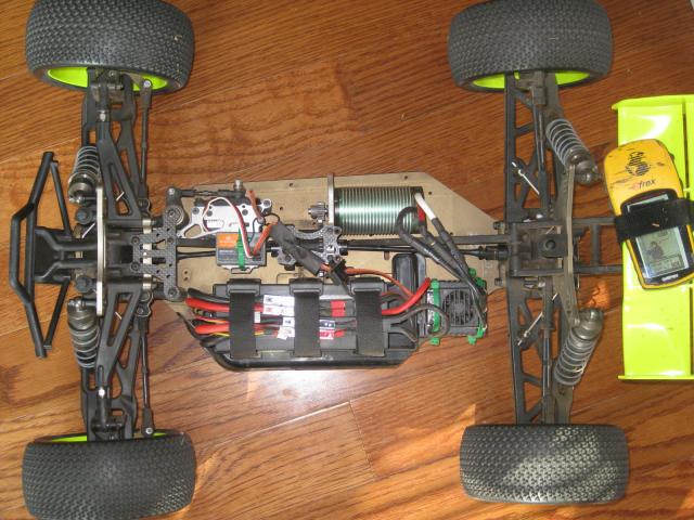

Got the conversion done. I'm running the 2200KV motor with a 14t pinion. Top speed is just under 36mph running two 5200mah 2s hardcase packs in series. Tires are Proline Calibers.
That top speed seem right?
Update. Retested top speed with a freshly charged set of packs, high 39.7mph. Went down to 38.3mph after about 5 mins of running.

Nice but I think u need to put sponge at the Lipo as there's gap. The motor wire is too short too. When the car flex most likely it will disconnect.
