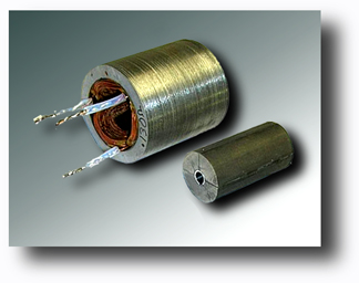

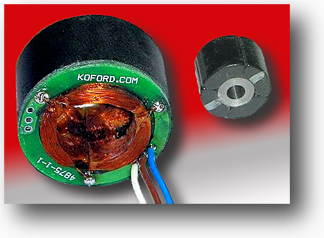

Have a gander at this:
4 pole rotor & slotted stator
2 pole slotless stator
The rotor on a 2 pole motor is usually a solid long, round magnet with the shaft running through it. The rotor on a 4 pole is made of 4 separate magnets fixed around the shaft & wrapped in kevlar or carbonfibre usually- the stator is designed to work with a certain type of rotor so changing it could cause it to not work properly, or not work at all.

Koford seems to wind their 4-pole slotless motors the same way the R/C slotless 2-pole motors are wound.
Not the same ...
To do a four pole winding, you need either a 6 slot salient pole winding or a 12 slot skip-2 winding.
To do a two pole winding, you need either a 3 slot salient pole, or a 6 slot skip-2 winding.
There are other winding possibilities, but you can't take a four pole winding and just throw a 2 pole rotor into it, or vice-versa.
