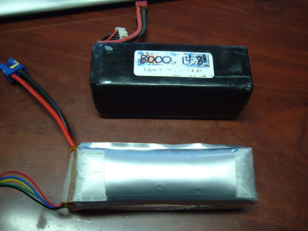

I know the guy linc DBB888 on GSRCRC from Edison NJ - It was a Losi 4s pack correct?
I sent him your way... I can't see pics from office

Yeah, looks like a losi pack, has a losi balance plug (another style plug???, shoot me now!!!) and an EC5 connector, and is 4s. I am guessing that he wants a 3s pack, but I am not sure what balance connector he will want, as I do not have the losi plugs and an not sure where to get them from... Actually he may be in luck, I think I have some sort of equinox adapter with the losi plug on it, or maybe a tp plug will work, pin spacing looks to be the same...
He also sent me a maxamps 8000 4s pack... I vaguely remember him pming me but I cannot remember what he said, and no instructions in the box either Plus that thing is WAY out of balance, with some of the cells over 4.2v... Does this guy have a balancer? I think he needs one, or some lipo charging "tips"...

The Losi should make a decent 3 pack. Looks like the other cells are ok, all are under 3v per cell, but not below 2v per cell so they should charge back up. Might have some loss of capacity though.
I have the maxamps pack balancing out right now. It had voltages of 3.97, 4.35, 4.25 and 4.14... It will probably take all day to get down to sub 4.2v on that one paralleled pair. Looks like he charged it without a balancer, as the pack voltage was almost at 16.8v. Good thing they can take a bit more voltage than they say, but anymore and it may have popped... Plus he may now have a weak cell in there... God I hate 2p packs with issues. I will most likely have to separate all 8 cells and make up 1p packs and then test them in something, just to see if the cells can handle load. Then I get to weed out the bad cells and then make something out of them, all while not destroying the tissue paper thick tabs.
