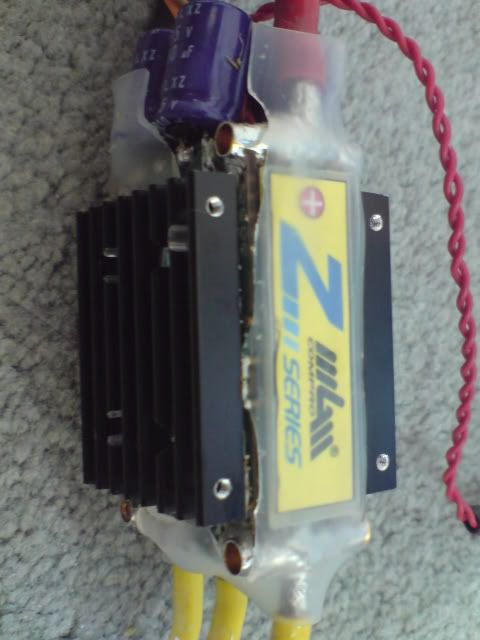

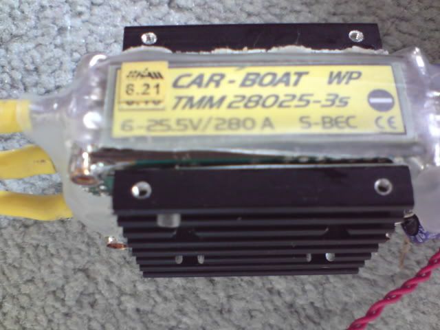

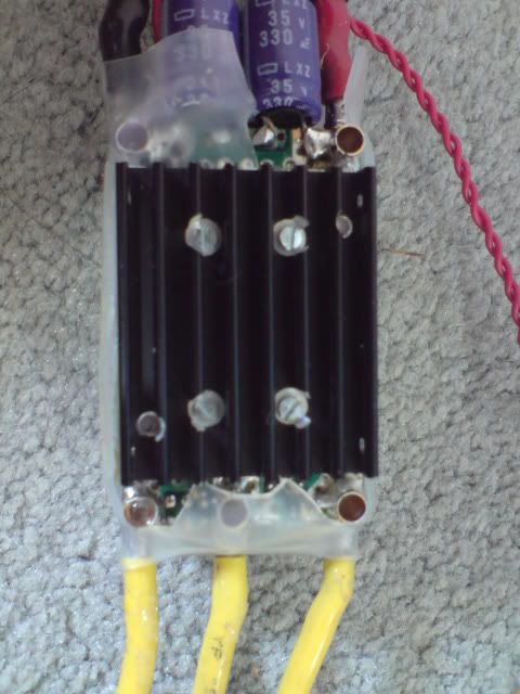

I just pulled the motor and esc off the truck and found i have melted the bottom heatshrink on the ESC, can i just unscrew the heatsinks and re shrink wrap it?

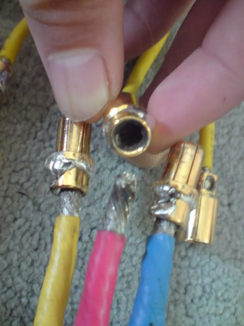

Also, when i pulled the heatshrink off of the gold connectors, i found one of the motor wires had become detached and was only being held in place by the heatshrink. Looks pretty toasty in the connector. Could this have caused the overheating, or is it definately the gearing?
any help would be good, i think this is definately operator error though
  (#270)
11.24.2008, 11:50 PM
Which solder did you use for the bullets? You can just re-shrink the MGM. Make sure to hold the lighter as far away as possible so you don't fry the internals. Why not retrofit your motormount to be adjustable? Why would you (in your right mind) gear so high?
