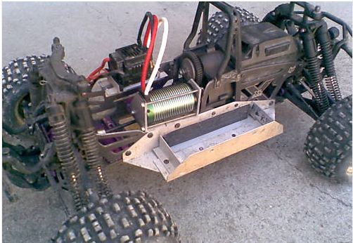

Originally Posted by Sammus View Post
depends how you gear it. probably get 150km/h out of it... wont go very quick though.
i had a savage xl running the castle neu 2200 on 6s zippy cells. geared to 40mph was more than it needed and nothing warmed up significantly.
what conversion kit did you use and what was your gearing?
Sammus
Sammus's Avatar
Posts: 1,161
Location: All over Australia.
09.11.2009, 11:08 PM
ran it the most with the 3 speed and the 2 speed, an eventually replaced all the internals with the flux gearbox so i had reverse etc. custom built engine mount and battery mounts. just out of some aluminium angle scraps
I think i was running 16/46 with the flux gearbox.
