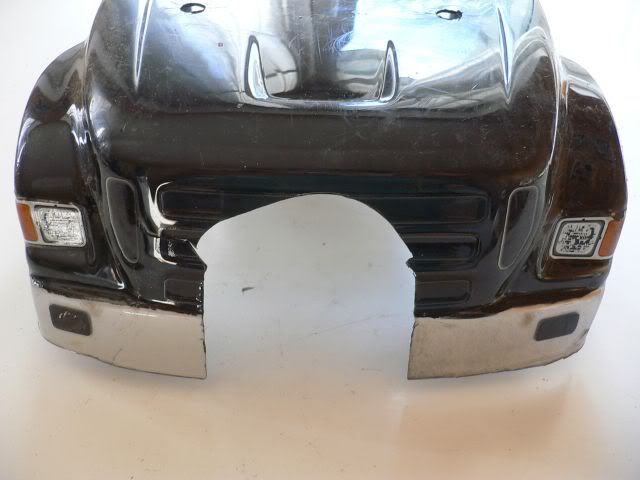

I run my 6s maxx three times since I updated it. Result : a mix of bad luck and disappointment
Bad luck :

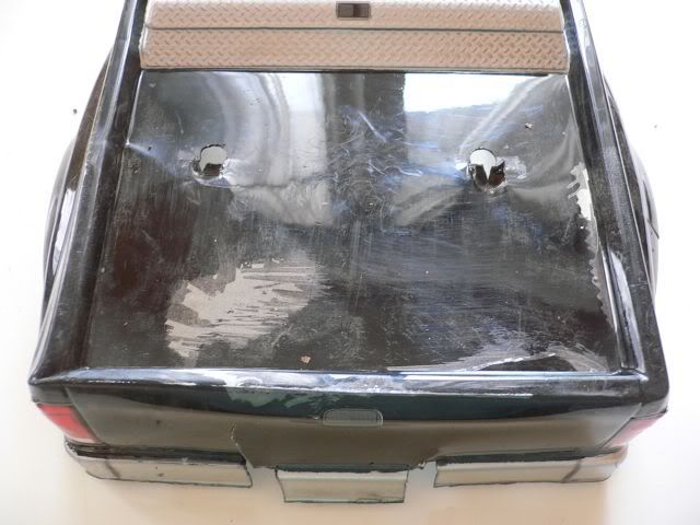

First jump - first tree...
Paint peels off and some breaks...

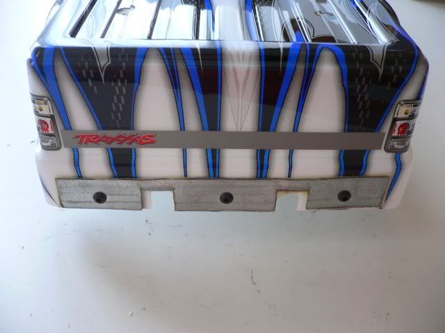

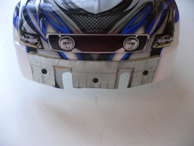

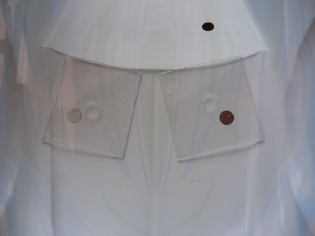

Maybe my front notches were too big I don't know. But given that the lexan is thick, it breaks rather than splitting. So I will never buy again this type of body ! I keep my stock bodies, easy to prepare, sturdier. I made that to reinforce them though :
(From my old 3906 bodies ! )

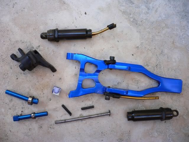

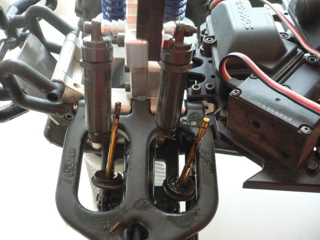

Aaaaaarms...
I broke these arms during a bash session in a really bad spot with too much trees... But I often break lower front arms, so I ordered FLM alu arms (just for these ones).
These tires are great (good grip, design, no ballooning), just bad luck... It happened once with my Mashers.
Really huge jump It's the first time I break shocks like this

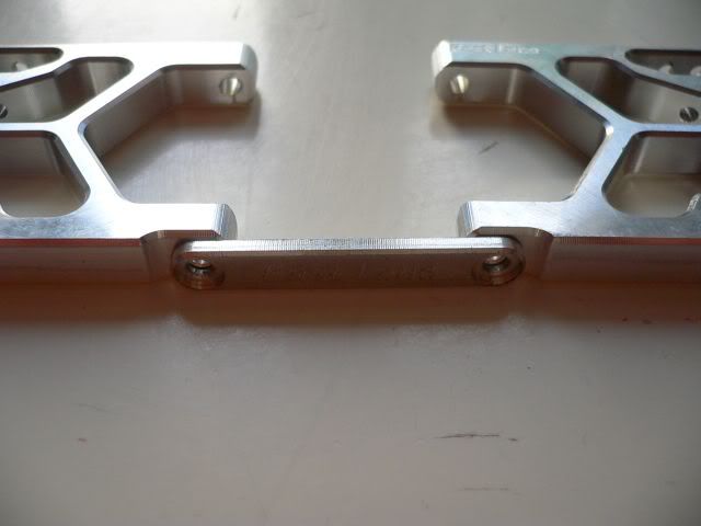

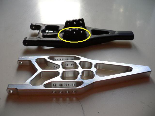

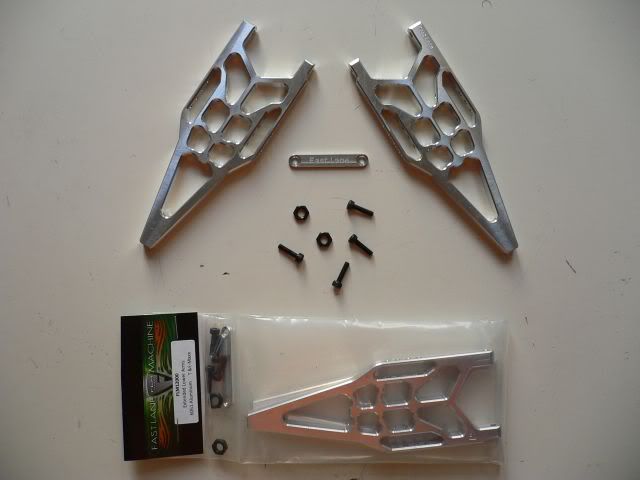

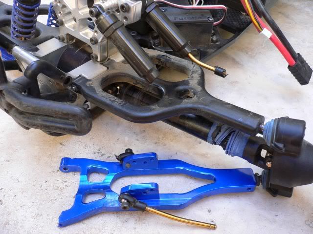

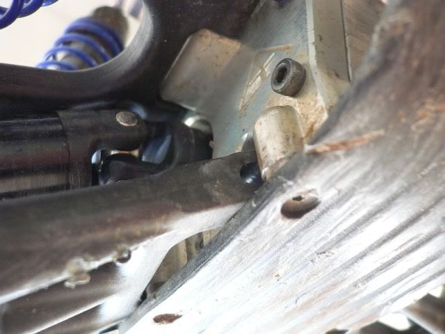

I received my FLM arms, they sent me 2 packs but I only paid one
^ This idea is great, and the eclips are inserted in the brace.

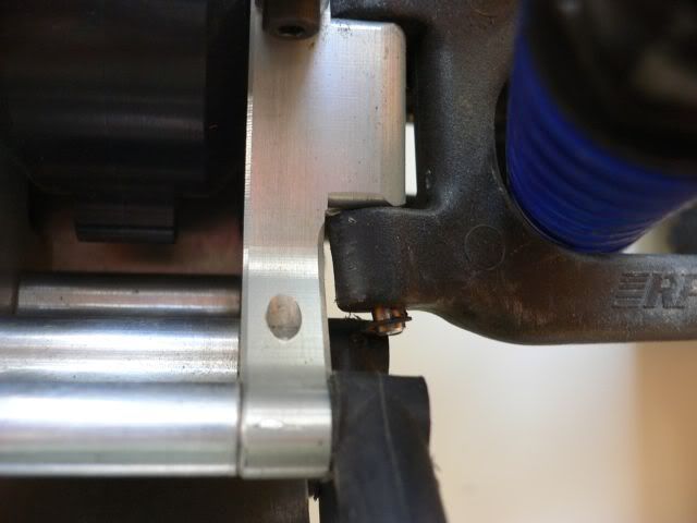

But big mistake for bashing use... There is no lower shock mount so the shock cups rub against Traxxas tubes if I want to have the same ground clearance as I had with my RPM arms (almost no friction with the stock turnbuckles but I had only one in stock...) . And the pins of driveshafts yokes rub against the arm so a dremel job is required (a tad, no big deal).

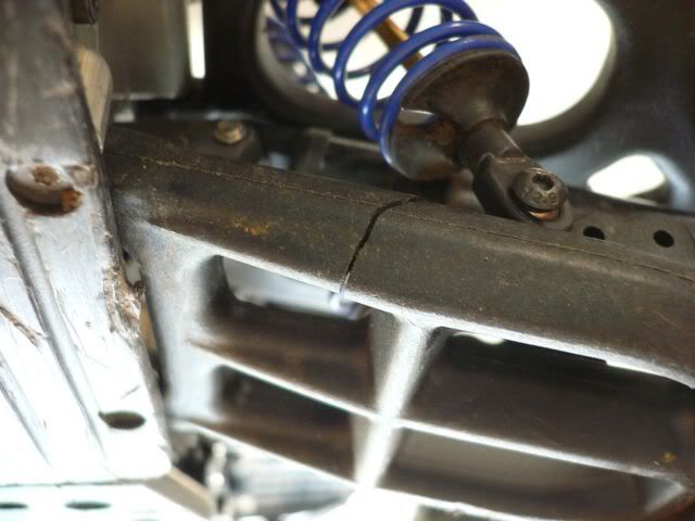

So I need to find a solution to fix that (if you have any idea I'm interested ). Yesterday I decided to test Integy (yes) arms I bought a long time ago for my 3906 E-Maxx. I used an older version of these arms which hold out great (I know it's odd for Integy parts, sometimes they are good).
But after 10 minutes of bashing :
I hit a tree stump at full speed (vid next week)...
  (#30)

A 6s E-Maxx combined with my driving style (brilliant or stupid, but always violent !) isn’t a good combination…
My maxx can’t endure the weight & the power of my new LiFe packs due to the suspension design a bit outdated for the powerful available BL systems and lipo setups.
During a landing, all the weight of the maxx is transferred to the front lower arms, and they break, like the hinge pins. Better shocks could help but 6s + hard bashing is too much for an E-Maxx
A solution would be to use a 4s setup but now it’s 6s or nothing ! So I keep my RPM arms, my LiFe packs, my almost-bulletproof E-Maxx, and I will be more kind with it next times… The next and last step of this build will be to buy Ofna shocks.
