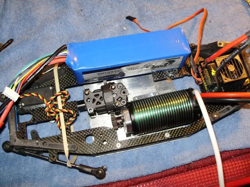

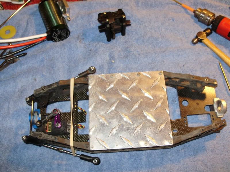

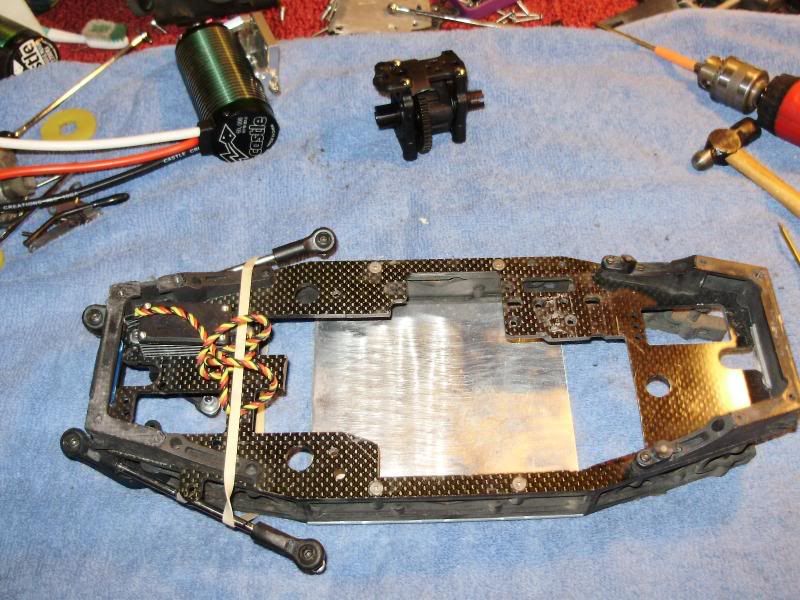

Update - 01.12.2010, 07:01 PM
I decided since I have so little money in this build I sprang for new chassis rails and uppers. These are a little war torn so if thing comes out working nice I'd like to to look the part as well ?
This is only mock up, Still need to counter sink holes in Lower chassis plate that I made today and do some more trimming to the upper CF plate to let the motor slide a little more over to the left. Once I decide exactly where the CD will go I will make the center axles and start bolting stuff down and start thinking about braces, not sure if I'll need them or where they'll go yet ?
Hopefully this Friday the SmartDiff and 45T plastic spur will show as well as the shock parts. Luckily I have a few sets of the Muggy diffs gears so I'll rebuild the diffs Weds with 3K Rear and 7K front. I've decide since it was to late to cancel the Muggy shocks I was go ahead and build them and install till I decide what 8ight shocks to use (I need overall measurements to compare to Muggy Shocks)
Also, need suggestions for a no frills Battery tray thats not going to take up a lot of room ? Thinking of using thin "L" angled aluminum in 1-1.5" for all 4 sides ?
Anyway, Here's a peak

Nice use of the diamond plate and all of the CF . You set up should be fairly light. Curious as to why the 8 shocks and not the muggy/LST..is it weight savings you are after or a performance advantage
