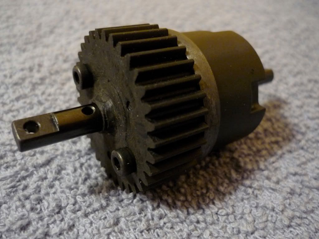

SUCCESS!
I annealed the metal, made a divot with some diamond dremel bits, and then drilled with carbide bit and tapped with cobalt tap. Couldn't believe how easy the drill and tap went through. I almost wonder if I softened too much or if the bits just made it that easy? I wasn't that surprised at the carbide bit chewing through the steel, but the tap was also much easier than I expected, barely required any force. The threads seem solid though and the drill bit was 2.5mm.
I feel kind of dumb now. I had this turned into such a big deal in my head and it turned out to be no problem. Oh well, it's done now! Going to do a test fit and see if anything else needs to be changed. Thanks again for all the help guys!

Test fit confirms everything is A-OK including the shortened outputs. The screws are very close to the inside of the trans case, but a few shims on that end gave them enough clearance. Rotation is smooth all the way around with no binding. All there's left to do is fill it up with silicone oil and make sure everything seals up tight.

I'm so glad it's finally done Just joking SC If everything checks out, if it rolls nice and free inside the tranny and there's no big leaks then go out and enjoy it, you'll love it for sure. Great job.

It was definitely a learning experience. Knowing what I know now I could probably put one of these together over a weekend. To anyone thinking about making one of these diffs: if I can do it, anyone can. Don't be intimidated by the hardened steel, it's very do-able with the right tools and right advice.
