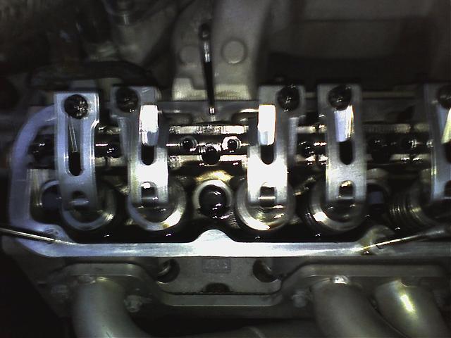

Tried the whole dual spa fans but never did like them. I had promax put in some annular booster inserts into the downlegs. The LM1 meter says I'm dead on with my tune. Only thing that gets on my nerves is setting the lash every so often but the jesel rockers help them stay within spec(.018). I still have alot to do and really want to go to a solid roller but not just yet.

That 340 has a shaft style rocker base right? I know I had problems with valve adjustment with the 454 till I put a brace on the studs. I was only running the Z28 springs, 1.6:1 comp roller rockers, and I think the lift was like .480" on the cam.
I did later build a 400hp small block and used the Rhodes hydraulic lifters, they took some of the lope away but didn't improve the idle vacume??? never could undersand how that worked. Still I liked them.
Wish I could have gone mechanical roller cam/lifters with a belt drive and aluminum heads, but man that stuff was EXPENSIVE 10 years ago!

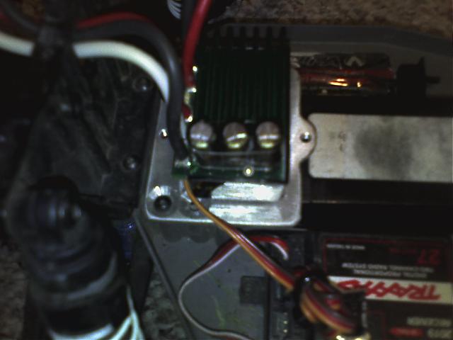

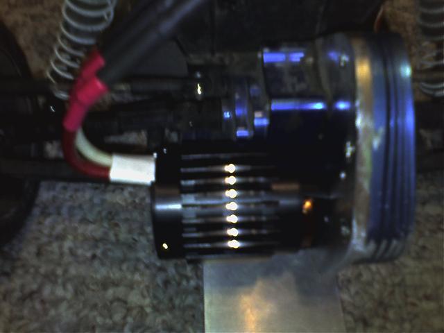

I got my first run in and I'm not happy with it. The temps on the motor were131 max but the controller was 219 and it shut down on me twice. Also top speed with same gears, lipo, ect... was alot slower. Am I programing it wrong? What is a good setup on the controller? Also the lipo was the same temp. as normal.

what speed is it geared to? You may need to gear up some. I would think that ~40mph should be close for a starting point. Remember that 6 pole motor makes tons of torque so tall gears will not make it unhappy. The esc will be switching overtime with small pinions causing it to heat up.
If I remeber correcly the high pole count motors like more timing and more punch control. I'll get that fan info for you in a bit.

Heat is produced by waised wattage. In other words your MM was acting like a 300watt heater and an ESC :(
The difference in the two motors is the pole count. The 2 pole motors don't produce as much torque but they spool up well and have good high end power. The 6 pole motors make tons of torque and bottom end power but the get less efficient at higher RPM's.
Lots of gear should bring the rustler around.
What settings were you running on the MM? I'm guessing by the sound of the lack of top end speed you are at full throttle and max rpm alot?
The teps should be fairly even for the ESC, Batt, and Motor. With the motor being a little warmer than the rest. Seems like 140*f is the max acceptable for all the components.

Holy crap I'm a moron. It's all my fault for it not working right. When I first turned it on I had to do the whole radio thing. After I did that the forward was reverse and visa versa. Not really thinking too much about it I just flipped the channel switch on the radio. During the first run with the guys I didn't use my brakes but later(during lunch) I was out back bashing around the RR tracks and noticed that when I hit the brakes that it goes into reverse. That got me thinking then it hit me I had the wires to my motor backwards. I set it up to have 75% brakes so there for I was only running 75% forward with the wires backwards. Man I feel stupid.

Don't know about the brushed cleaner? I use a shop vac (never compressed air, it pushes stuff into the bearings). Once in a while take the motor out and make sure it spins free, you can get bad bearings or iron filings stuck on the rotor (like putting a magnet in the sand, you pick up stuff).
