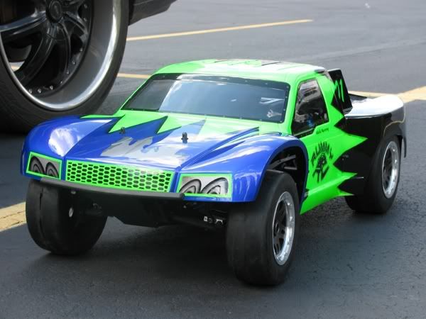

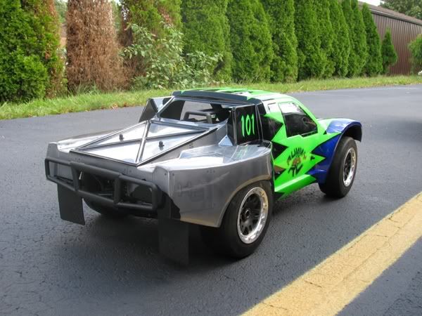

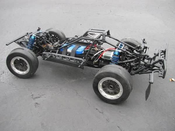

Chassis came back from the coaters and a buddy of mine let me borrow his hostile slicks for some on road testing.
Looks pretty nice all mounted up I think!

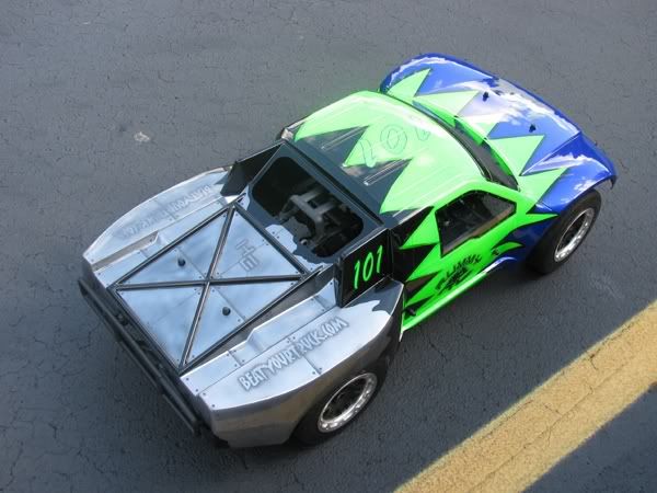

Got the body back and couldn't help but throw it on for some quick shots too!

Looks nice. You really wouldn't know its not an e-converted Baja, except when it starts roosting from all 4 wheels.

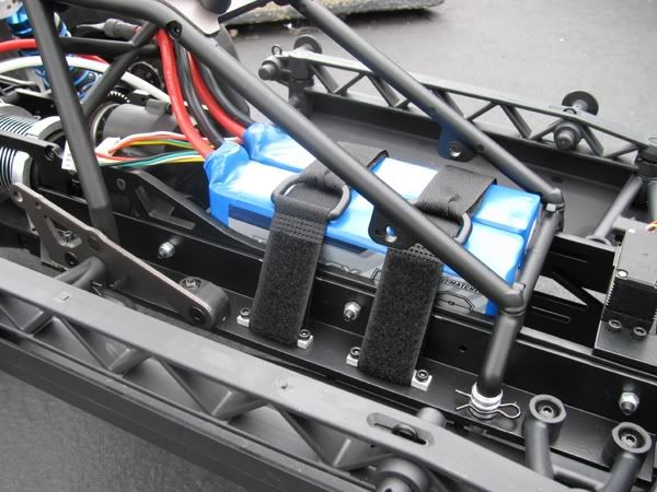

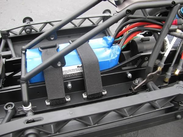

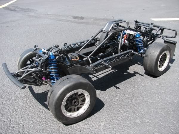

Battery packs now have a place to live. Strapped in nice and tight. Truck is sitting at 24lbs the way it is in this photo with the body mounted.

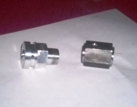

Prototype hub should be here this week!

That hub looks nice. Bolt on is easier than modifying an extended 23mm hub and wrapping it with aluminum tape like I suggested too! Is the piece on the right the nut or an unfinished hub? I'm confused by the hole drilled in it, set screw?

The piece to the right is a drilling fixture. The axles require a new hole to be drilled in them for the baja 4mm pin. Basically slide the xl axle into the fixture, put a wheel nut on to hold it in place and then drill a hole through the opening in the fixture.
