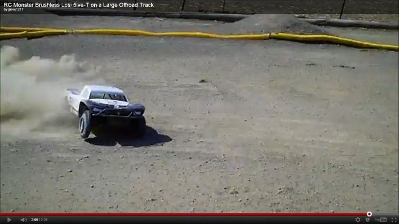

03.13.2012, 07:35 PM
yup:-)
i got more video sunday.
and i got to do a serious test at the track today.
i got 12 minutes run time at the track with out any stopping. 75 degrees out .motor was 200 degrees ( no fan) esc was 120F
150 amp current limiter . lipo cutoff was 3.4
17 T pinion ( way faster than a 200 foot straight could handle. tires never stopped spinning.
jumps are a 1/4 throttle blip .any more and i have to fetch it from the corn field. actually is drove itself back from the corn lol
and to compare it to a stock gas truck'
and another just bashing

yes 8 HP and that is traction limited. and had a 200 amp current limiter at that time.
