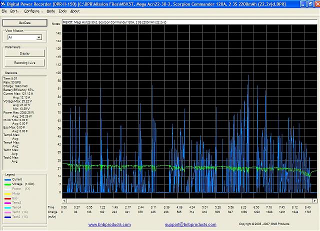

This controller is doing an amazing job of starting the Mega without any issues. I just ran it again and I'm more impressed now. I ran my truck on a football field and it was awesome and you can really feel the difference with the Motor Start Booster. The controller ran cool for 8 minutes as the pack dumped on me. I can't complain and it put out a max of 2055 watts, avg. of 242 watts and a max of 121A, avg. of 12A. Not bad at all. The Mega is getting a beating though.
