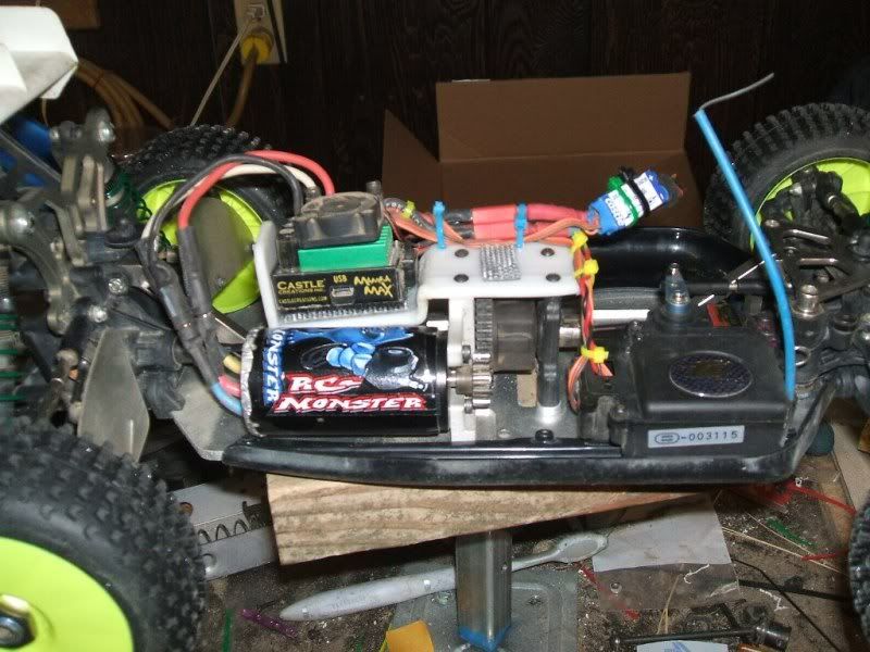

Drift_Buggy did the mount you have your MMM on come with the kit? Any problems with clearance when the body it on? I need to come up with something different for my 8ight. The body sits right on top of the fan I have on my mm. From the first picture in your thread it doesn't look to have too much of a bend more like an angle down towards the chassis. Is that right? Thanks.

I used my dremel tool and cut that 'esc stand' stand down basically in half. I used the current wire routing notches as the new height and trimmed it all the way around at that height. Then I made a few more custom notches on my lowered plate and also flattened the three screw downs for the personal transponder on the bottom side and I just used some 3m heavy duty two-way tape to hold the transponder in place. PERFECT FIT!

Sorry I took so long to reply. By the looks of it the cornor of the fan cover will just hit the body but the instruction manual for the esc kit said you can bend the plate down more to clear the body.

Thanks. I have a friend that owns a sign shop. He gives me the scrap lexan leftovers. I tried to make one similar to the one you have. The first attempt didn't get the esc low enough. The second one got the job done. I'm working on a battery tray made from lexan. Using the toarch to bend it into shape. First couple looked like something you'd bring home from 1st grade made out of clay. Is it an ashtray or a coin holder? Thanks for the build thread. I've looked it over a lot since I started thinking buggy. It's helped a lot.
